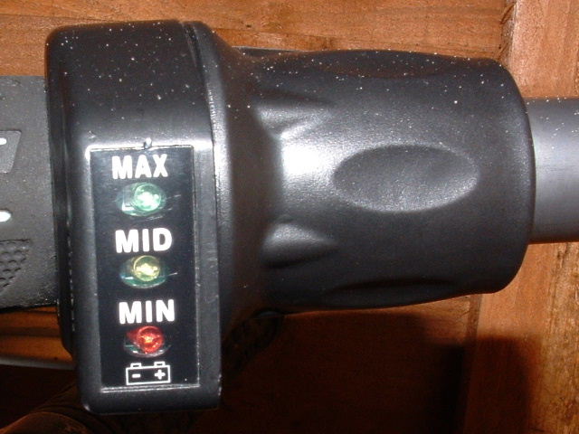

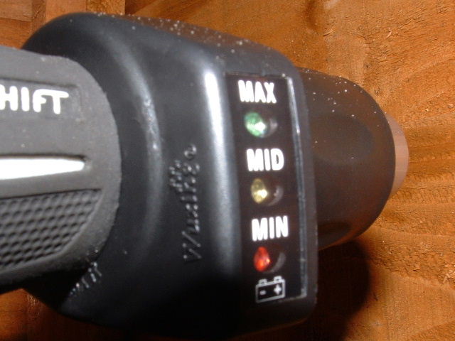

As promised here are a few photos.
The throttle brand name is Wuxing. There are five stars above the word as well. The other markings on the throttle read LT25XK.

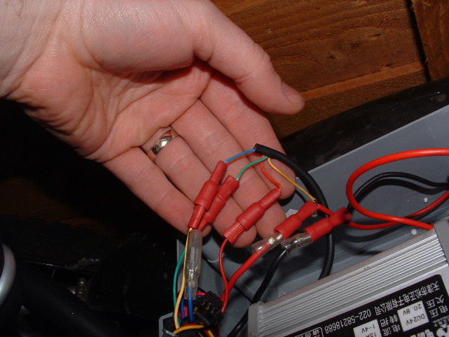

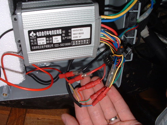

There are four wires from the throttle. The instructions said to run the yellow one to the red +ve from the battery, red to red from controller, green to green, and blue to yellow from controller.
As for the controller, does anyone read Chinese?:)
