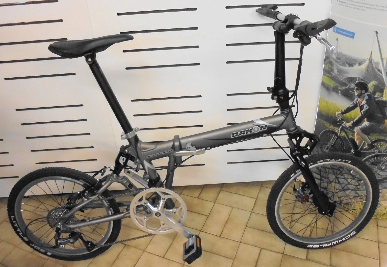

For more climbing power, you could install a BBSXXX onto this brand new full suspension 20" wheeled Dahon Jetstream, custom built by CH White, the Dahon expert dudes. I don't know if the Jetstream's suspension is any good for whatever your Special Purpose is (I suspected it was to get mad cycling fit), but as a former owner you do.
