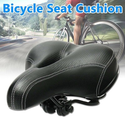

unfortunately all the suspension posts I know of add several inches in height to your seating position. if you’re seatpost is already as low as it can go, no suspension post will work.
your next best option would be a sprung seat, I have one of these on one of my bikes. (I’m 93kg and it’s definitely better than an ordinary saddle)
Cheaper direct from China if you don’t mind waiting for delivery
