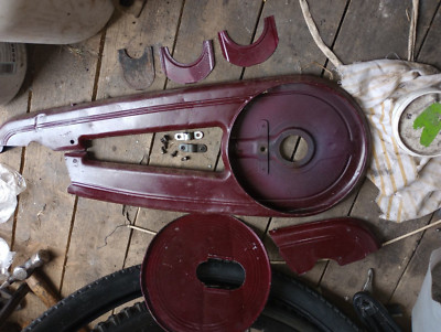

A possible "kwik-fix", might be with really heavy duty chains, running on fully hardened sprockets, all at least twice as wide as the present versions, plus instensive cleaning and lubrication as least once a month, or possibly an old fashioned, fully enclosed, chain guard, to prevent dust/mud/water getting on the chain. My first bike had one a great many years ago!!
Or:-
A modern design, in a lightweight material, might reduce the need for chain cleaning and re-lubing!
