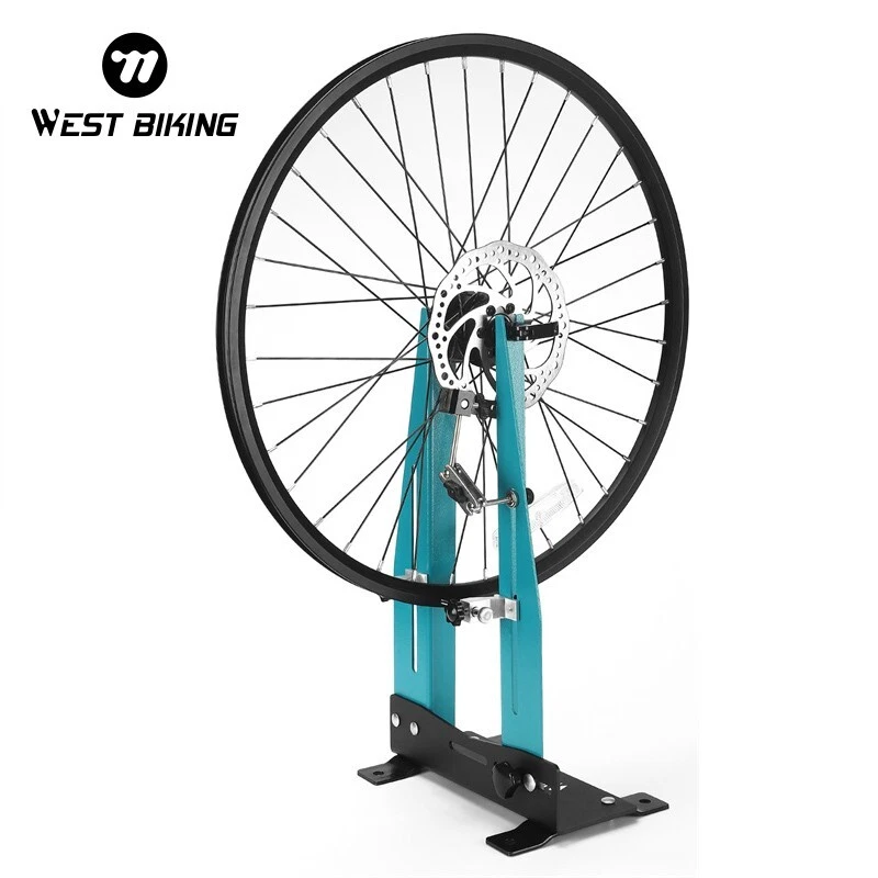

Yep fiddly and unpleasant, and only when I couldn't locate the Park Tool type mentioned earlier, or the horrible circular roulette type. I have rim brakes, and thats the reason this far I've needed to true. Ordered these the other day to try, which should be an upgrade to zipties... but I may spring for a truing stand at some point...I'm guessing you've never done any serious wheel building or re-truing as using such spanners would drive you insane - their shape/design would make the task endlessly long/labourious/tedious - just saying.
