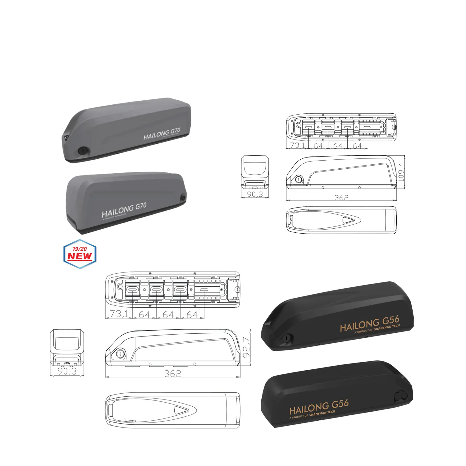

if just the 2x power connections are fed out it could be one of the hailong mounts in this ad?
edit whoops battery not mount..
most if not all batteries will come with a suitable mount so if replacing a dead battery not a big issue unless wanting to use both old and new batteries alternating.
The ad above suggests your battery is type "hailong G80 box"
