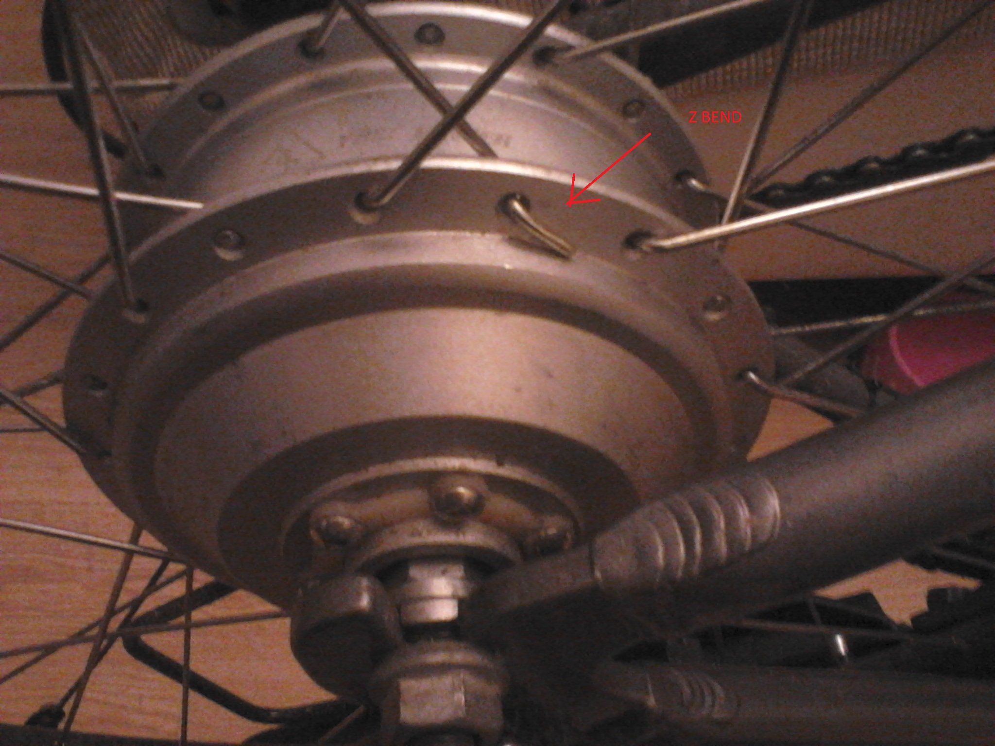

Important info for Swytch hub:
  • There is a 250-watt and 500-watt hub, but I believe the settings for both are the same.
  • The hub uses 6:1 ratio with 16 magnets in it. (To determine P1)
  • It has 1 magnet for the pulse signal (For P2)
  • The rest of the settings are attached, but are my setting preferences, where applicable.

So P1 is 96.

Correct (6:1 Ratio) 6 x 16 Magnets in the internal Hub (Per picture) = 96

22A is too much for a Swytch motor. You need to cut down the max current in the settings, especially with a sensorless motor, like the one shown above. I'm not sure, but I think they changed to sensorless motors after the MK1 kit. In that case you don't need to worry about P1.
