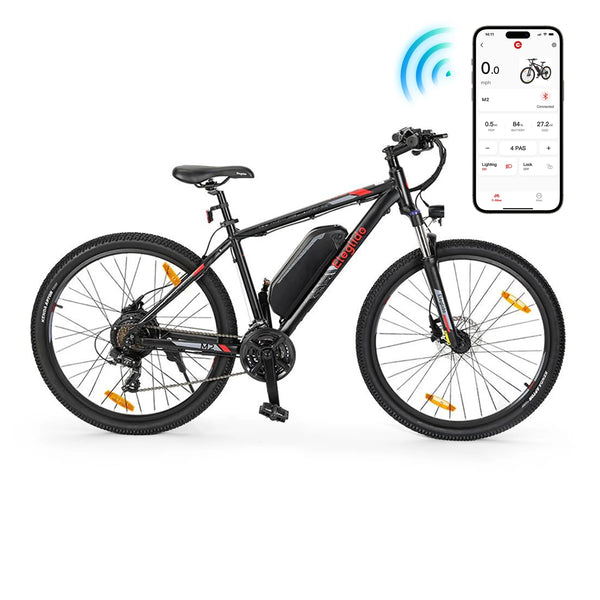

I think eleglide has been mentioned before as ok
For £100 more this seems a lot better spec, hydraulic brakes, much more powerful motor and a lot bigger battery

The bike I linked and the eglides that Peter posted all have standard batteries that are the cheapest to replace, and you can choose whatever quality you want because there's so much choice.
I like that Eglide M2, but it has a battery with an integrated controller that makes a replacement controller a little more tricky.

Looking at the spec for the eleglides in #12, they are 'speed control' with 5 levels.
Where does one need to look to get the generally regarded as better KT style 'current control' on an entry level bike, or does that simply not exist?
Peter.Bridge
Apr 19, 2023
1,261
583
Personally, I've not seen that on entry level bikes
