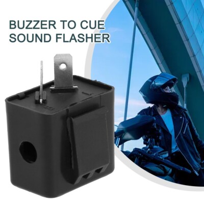

Tried this flasher unit, which works at 36V with those awful 6V-80V Bafang lights, but sadly doesn't flash the LED panels above.
It makes an intensely irritating weedy sortof engine noise at lower voltage. Two of these flashers at low voltage would sound even more annoying to everyone on the road - I can't decide if they sound more annoyng than bagpipes.

You probably just need a nominally larger current pull to register with your flasher unit, if you check out ads for led indicator replacements you see they highlight the inclusion of a 'load resistor' which adds the drain required by the flasher unit to register/operate. the flasher is a bi-stable switch alone the led panels dont draw enough to start the 'flip/flop' perhaps?
.... I used the Bafang headlight as a load with two of those very bright LED panels in parallel and.... Qapla'!! Very bright beeping and flashing! 10 seconds later, the lights went out. Burning smell. Dead 2A 36V cheap power supply. I should buy a set of resistors for this sort of thing. The power supply is glued together, no screws. I'll look at it later.

Good news is my cheap 3.5V - 36V(ish) adjustable power supply has recovered (powers two LED panels in parallel). Bad news is THE FLASHER OF BAFANG is dead! I've ordered some resistors. If sufficient enthusiam exists for installing foldaway ultra bright orange indicators on my bike's pannier rack, I'll get another 48V flasher.

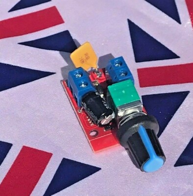

This arrived the other day - I'll test to see how much cooler these LED panels run at various PW Modulated signals... what those temperatures and frequencies are precisely (or thereabouts), I can use my shiny new Neoteck multimeter to determine. I'll run two panels in parallel continuously for hours at various voltages, and see if it dies. I'll do the same with the one above - can't be doing with a flash and magic smoke on the road. If I'm going to fit indicators, I want years of reliable operation.
