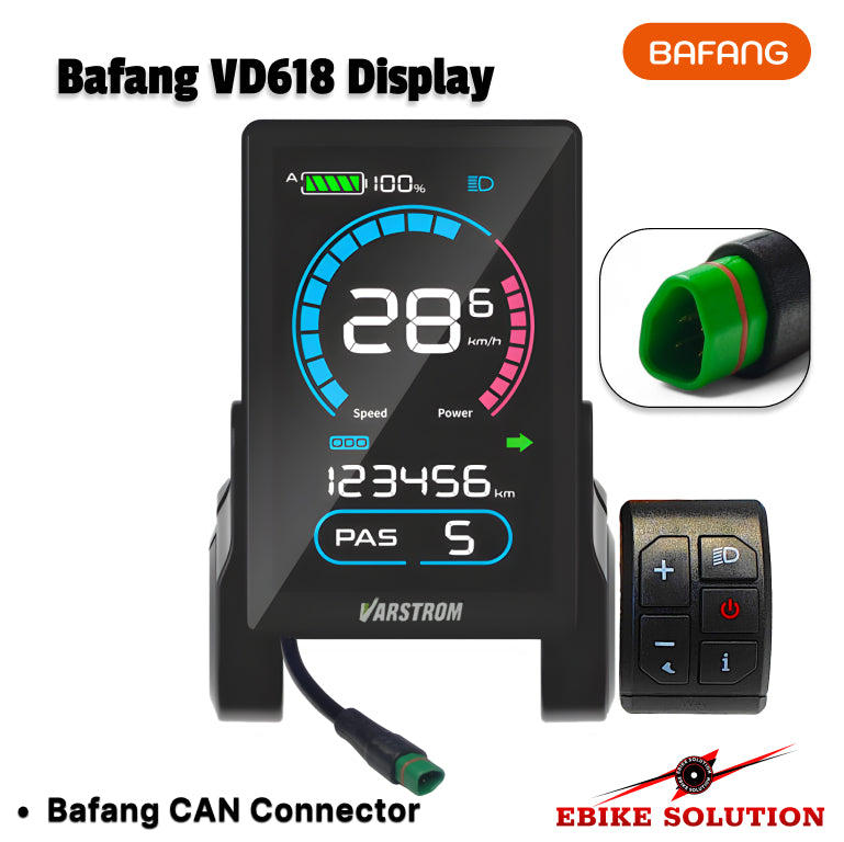

Hi - I’m really hoping someone more tech savvy will be able to help me. I bought a Buzzbike H700 from Wiggle a year or so ago. It has been great but unfortunately now has stopped working and is giving me an error message which is listed as “overcurrent to the controller”. Having done some research, I am pretty sure I need to replace the controller, which would be easy enough except that I have searched Ebay/Amazon/Alibaba and cannot find a controller with the same connectors.
I’ve tried contacting Wiggle, Bafang and three or four different ebike repair shops - no help forthcoming (no reply from Wiggle and Bafang, none of the e-bike shops cater for this bike).
Here’s my question: if I purchase a controller that has all the right specs but different connectors just for the PAS and display, is there a way to jimmy it together e.g. with some kind of generic connectors? Does anyone have any experience if doing anything like this? I would be incredibly grateful for any helpful advice.
