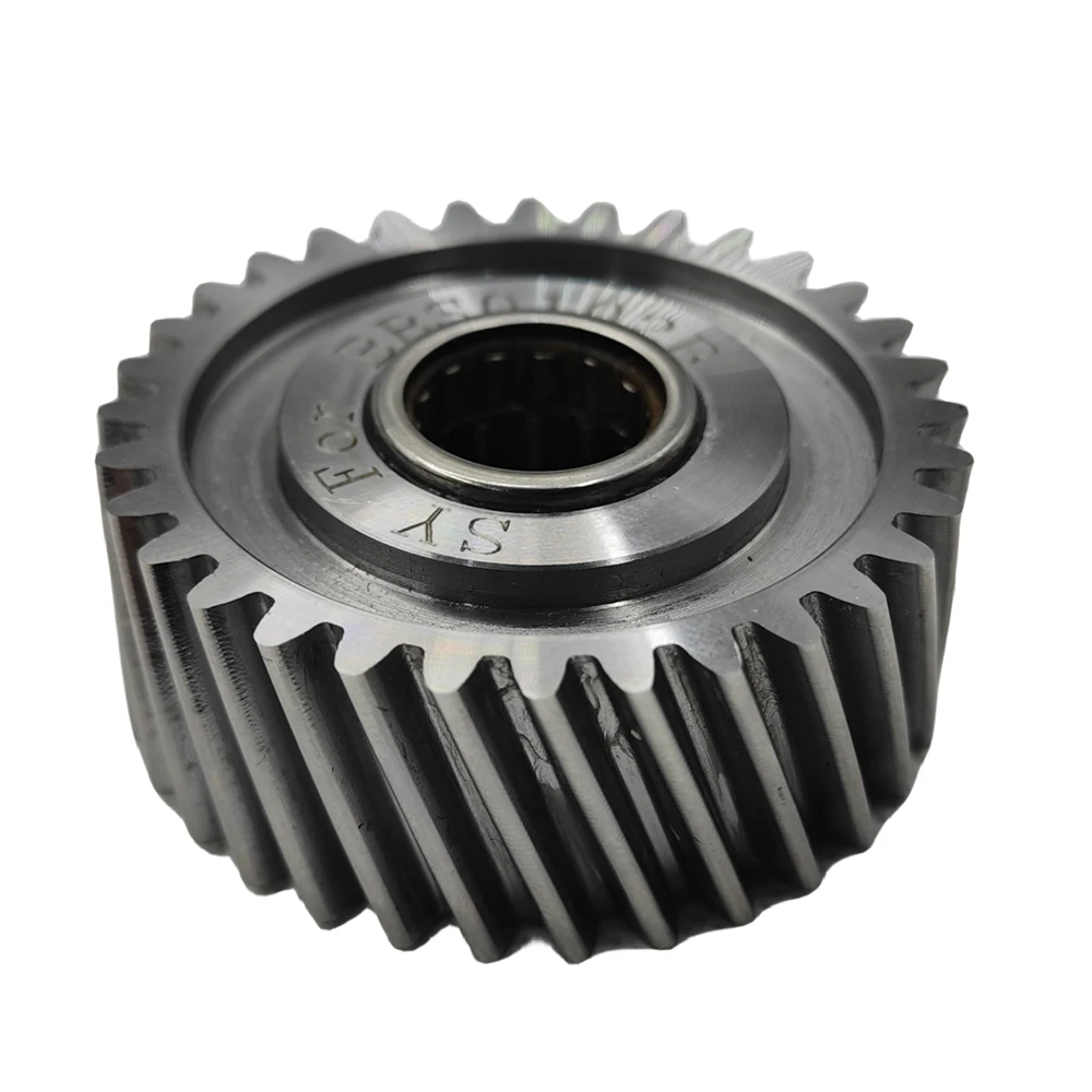

You can buy brass replacement gears for Tongsheng motors. People say they are not more robust than nylon gears and when people use their motors incorrectly, then they get shredded too.

Wow. Horrific damage there. No sign of any lubrication. Bone dry metal gears. Not good. Also possibly some misalignment issue - worn bearings perhaps. Mainly though, I'd say some naive person put that together bone dry after removing the nylon gear and replacing it with one made of brass.
Edit: on a Youtube channel I used to watch about Royal Enfield motorcycles, there was a case in which the steel gears of an old Albion gearbox were worn to shreds like that when it had no lubrication. Those boxes were sometimes packed with grease (early Indian made ones) and in this particular case, the bike was run in a spell of very cold weather here in England (rather than Delhi) and the grease hardened and was thrown to the edges of the box, leaving the gears dry.
12,080
3,379
Some brass alloys are self-lubricating, which is why many locks are brass - whoever manufactures these brass gears must have considered the puny ickle TSDZ2, and reasoned strong steel wasn't necessary.
To be honest, I don't see that there is much in common with the loads applied to a lock and an un-lubricated skew gear in a half kilowatt drive system. That is a very harsh environment and is a recipe for failure in my opinion. Steel on brass at these power levels is a guaranteed fail. Suitably greased up, or lubed with hypoid type oil is a world apart from what we see in those photos. Gearboxes in cars use special extreme pressure sulphur based additives for a reason.
