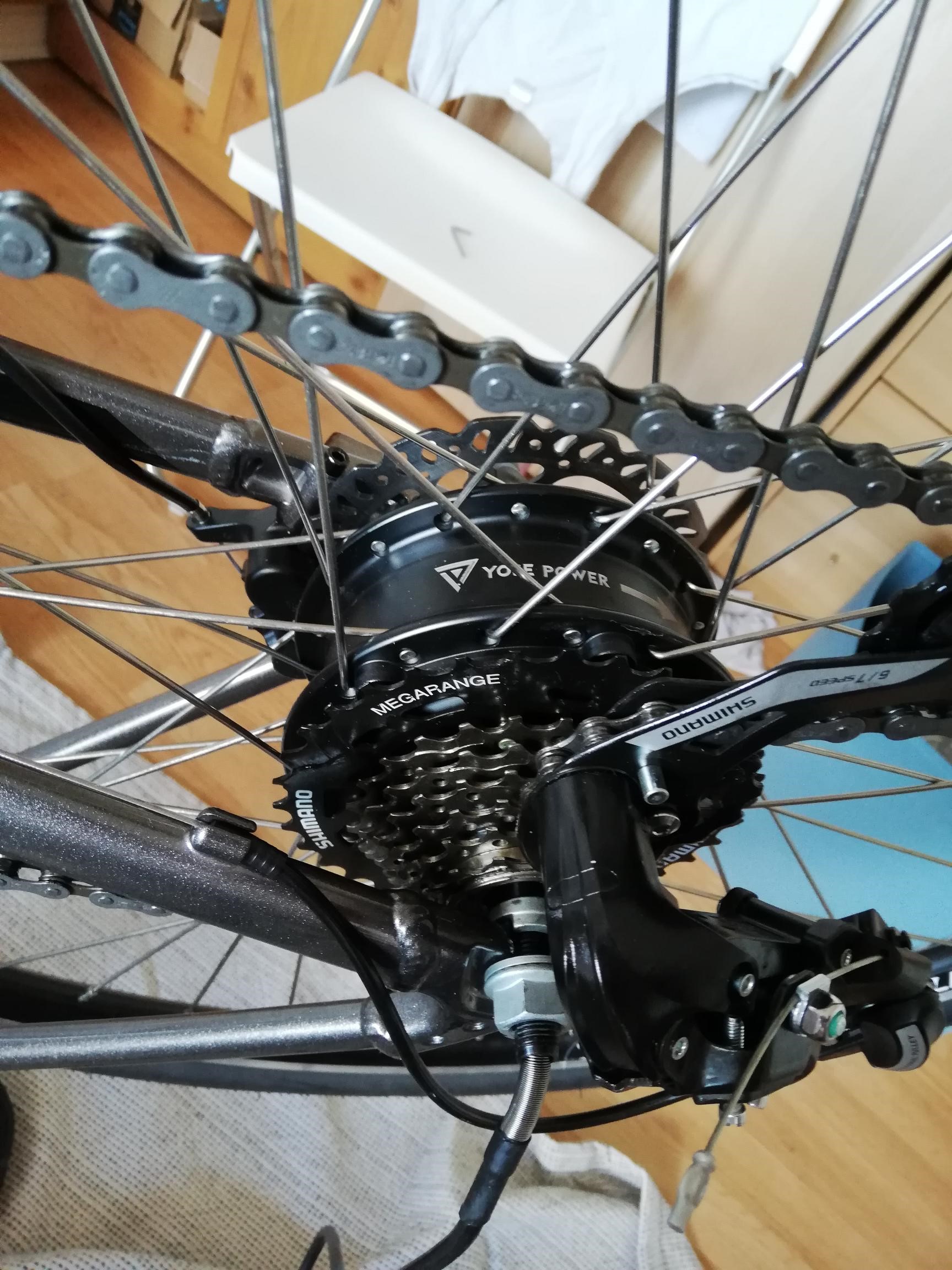

Also anyone recommend a chain catcher that fits a SDuro
When I first bought my Dahon, I was surprised to find this curious lump of nylon, which might be of interest to you:
41462
It made me laugh! Looked like a bodge, an elastoplast stuck over a bad design choice somewhere along the chain...
It looks easy to make - if you can't find something similar that fits. I refuse to believe that anything which fits a old Dahon frame, would fit anything other than another old Dahon frame.
Yes, I know the bike is very dirty, but so is the man riding it :p
I don't think it would fit.
