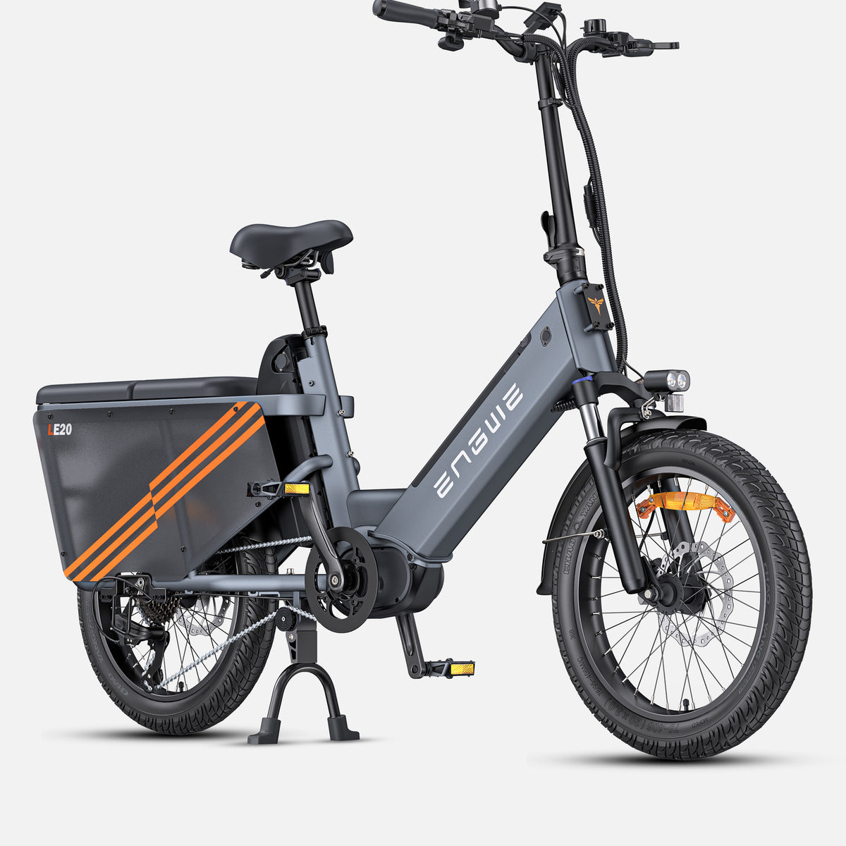

I'd like to see fat tyred 20" wheels, long wheelbase, a longer and stronger rack, passenger footrest option, powerful mid-drive, large and capable batttery, thru axles on the Tailwind Cargo 807, prettier and more powerful than this:
