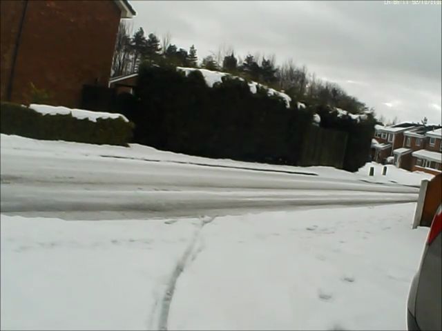

Assuming that it works like mine with one throttle and two controllers, the two wheels will always turn at the same speed because the controllers use speed-control. The traction on mine is like nothing you can imagine even on this very slippery snow. The underpass is 14% gradient. The front wheel was skipping nearly all the way up, but there was no problem with stability. Click on the picture.
