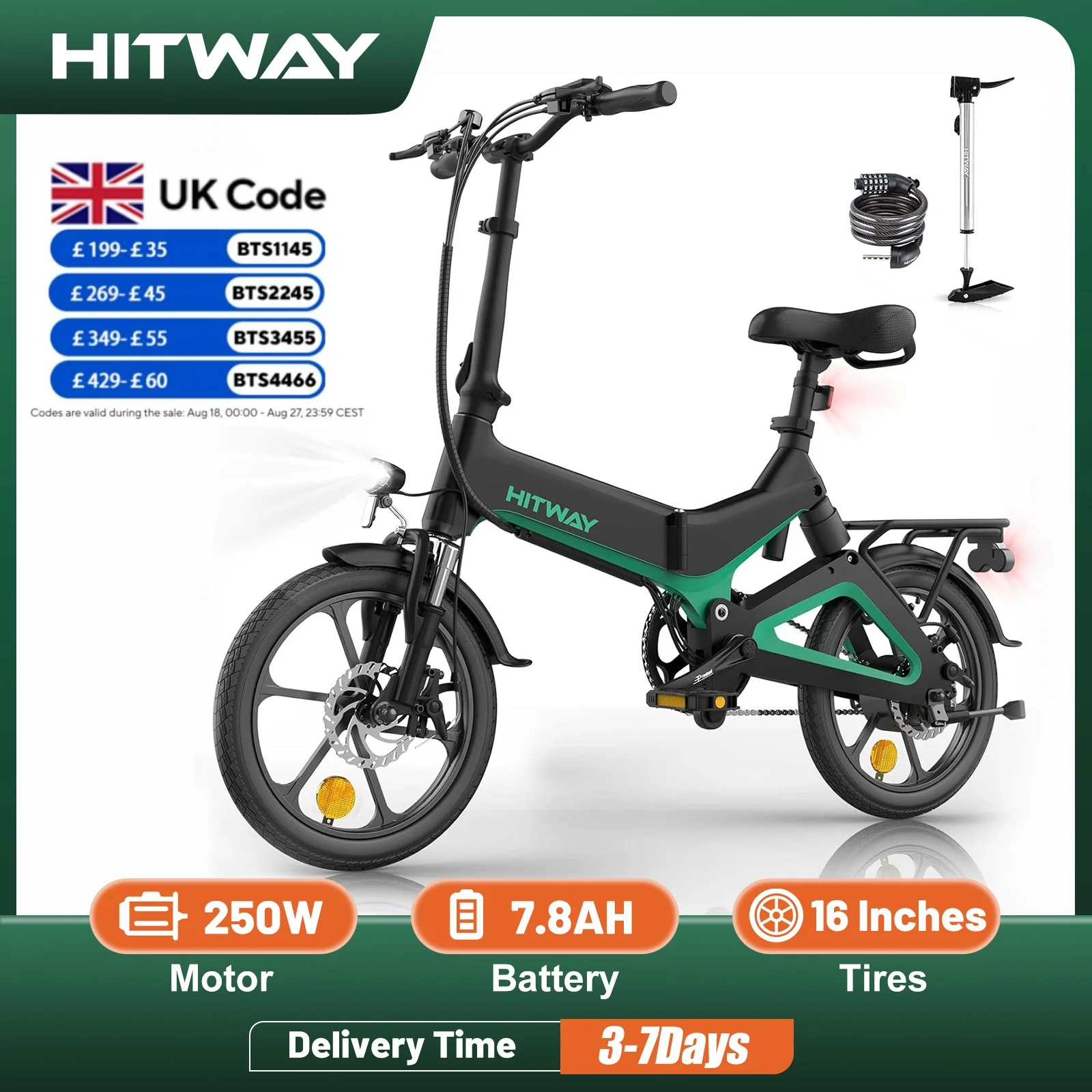

Then there's the Hitway for £389, which is a Mirider without some of their refinements. If you have a choice of either, it's difficult to justify the Mirider except for the support and backup for it, which effectively costs you the same as three spare Hitways!
