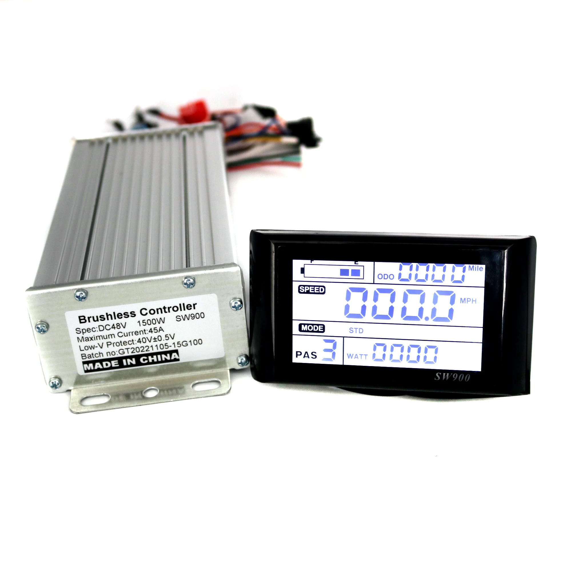

Hi good morning people just need a answer on my sw900 display
Says
P14 The Current-limiting of Controller. The original Current is 12A. Range:1-20A
Please check the current your controller and the hub motor can handle. Set the limit accordingly.
Does this mean I can only get 20amps from the Controller as its rated for 45amp max

Sorry Andy, that's completely wrong. It would mean that everybody with a normal 14A or 15A controller is running more than double what the motor can take. 250W (motor rating) divided by 36V is 6.9 amps. No electric bike has ever run with a controller maximum set that low. You'd struggle on a 5% hill.
I think you should be careful about questioning OP's knowledge of electric bikes when you open yourself up to questions about whether electricity is your day job and whether you should be advising people based on your comments above.
Most motors can easily handle 20 amps provided that you're sensible about its use and you don't have a high-speed motor, like a 20" wheel motor in a 26" wheel.

Iam still learning and reading all your input guys I've changed my controller and display both 45amp max but it was the setting that I mentioned as I can only set the limit on the display to 20amp does that mean it will only give 20amps to the controller sorry for sounding daffed

If it's a 45 amp controller, that 20 amps max on the LCD is probably wrong. Be careful. It might be an idea to check the current independently with a wattmeter.
Tell us which motor you have so that we can give sensible advice on current. Tell us voltage too. do you know the no-load speed of the motor? see if you can check the max speed with the wheel off the ground. Some LCDs will only go up to a certain speed, like 32 mph regardless of actual speed, so check too whether the LCD maxes out before the wheel.

My wheel is a 1000w 48v
£44.42 7%OFF | High quality 48-84V1500W Ebike Controller With SW900 LCD Display One Set
The motor speed is an important characteristic. A low speed one can run with higher current for more of the time than a high speed one. 40 amps is generally OK as long as you only use the high power in the upper half of the speed range. 45 amps sounds a bit high to me.
You also need to think about your battery. How much current is it rated for? You won't get 45 amps from an average 48V ebike battery, which would cut off if you tried.
