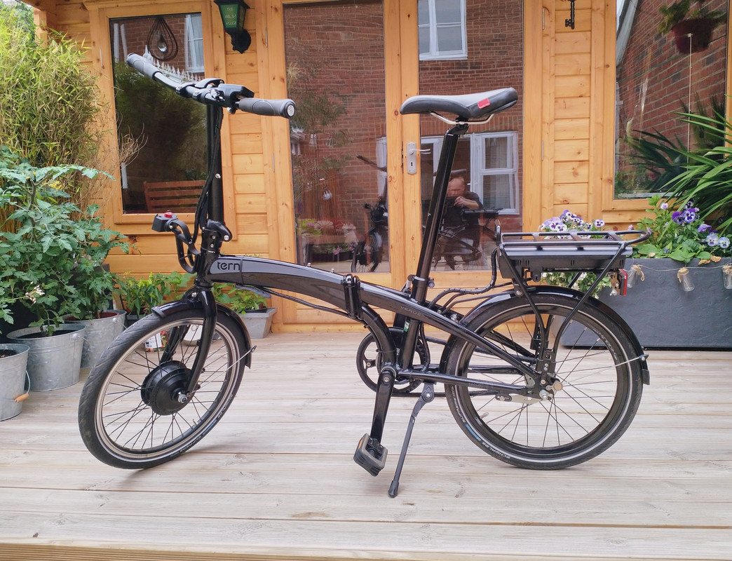

I'm an avid cyclist but recently my brother picked up a cheap 2nd hand electric folded, I loved it so much I bought myself a 2nd hand folder than I used to convert my tern duo into an front hub electric
Which is great, but then I managed to grab this on ebay 2 months ago
A woosh Gallego, and I love it
I think it takes its design inspiration from the Brompton with the way it folds at the back, complete with little travel wheels, and then just makes it a little better with its concealed battery in the frame and front hub motor.
I absolutely love it, its fast, handles well for a small wheeled bike, great brakes, easily removed battery and think it would fit your circumstances quite well.
