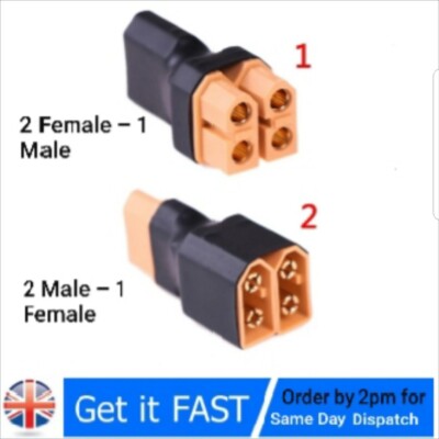

My battery cradle has female XT60 connector so I plan to add a splitter plug to this so I then have TWO female XT60s available, one for the controller and a spare for USB socket implementation. Second XT60 cable 52V (max 58.8V) goes to buck converter, buck 12V output goes to USB input. I will 3D print a small project box to protect it and probably velcro it to frame when using it, easily removed when I won't need it.
So I plan on buying:
Or is there an easier / cheaper way?
1 x XT60 Parallel Adapter Splitter
1 x XT60 Male / Female Connector 10CM Silicone Wire Cable 14 AWG
1 x DC-DC Step Down Buck Converter (15-72v) 24V 36V 48V 60V to 12V 5A 60W Output
1 x 12V USB quick charging port

I like your first idea much better, the cheap one isn't water resistant, has unprotected wiring etc. Fuses can compromise as much as protect. Stuff that shorts often fuses itself - cable damage is more of a risk.
You need a blanking plug for the second XT60 socket when it's not in use. The wire from XT60 to buck converter needs to be well sheathed, secured to the bike and stagger the joints. Keep that short and extend the buck to USB wiring as needed, much safer. These are more weatherproof than printed boxes:
Phones have recessed sockets so non-isolated USB should be OK with these two lots of smoothing... no?
