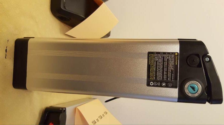

A little update: I found a battery seller on eBay in London who makes up batteries to order. He convinced me I would do well with a 24v 15 AH battery with his superior Boston cells that he would weld together for me (he talked my ear off!).
Well, the battery arrived today, and after a bit of soldering in the controller and fixing one break lever that had been holding back the power - it worked! My first experience on an electric bike, oh my goodness what fun :) On this little bike, 24v is good enough for me, I don't like going fast anyway. And it gets me up my hills without me hardly having to pump a peddle - almost too easy really! Not bad for £30. (Well ok, and £230 for the battery..)
20,925
8,534
61
You spoke to Jimmy then at Insat/BGA ;).
Reactions: RRSnel

I am sure you can guess the customer's reaction when he pays the full price for a new 13AH battery then messes up the battery in following our advice given over the phone.
A Gale battery looks typical enough, universal even, but there are quite a few catches. The location and size of the locking hole in the slider, the position of the battery connector, the dimension, the thickness of the battery connector pins and as D8ve said, the polarity. Not everyone has a Dremmel in his toolbox, that why I said earlier in the thread that we can only help if he brings his bike to Southend.
Sorry, she, not he.
I certainly did :) He had me send over photos of the connector to make sure I got just the right battery/polarity etc - great service!
I do happen to have a Dremmel but it was not needed ;) - though my husband did have to solder one of the motor hall wires back to its connector which is probably why it had stopped working for its previous owner.
