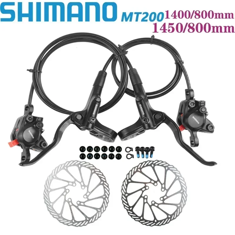

Needed to get a new set of decent hydraulic disc brakes for one of the bikes.
Found you can get genuine Shimano MT200 on aliexpress for about £35 or whatever. Make sure you order the front/rear left/right the way round you want it, and right length of hoses.
And then YosePower are selling brake sensors for the MT200 for £16, they just clip in to place behind the lever, and can even be adjusted
(you might need to cut the plugs off and solder your own on)
All seems to work well so far! The sensors are fitted in these pics, you can barely see them
