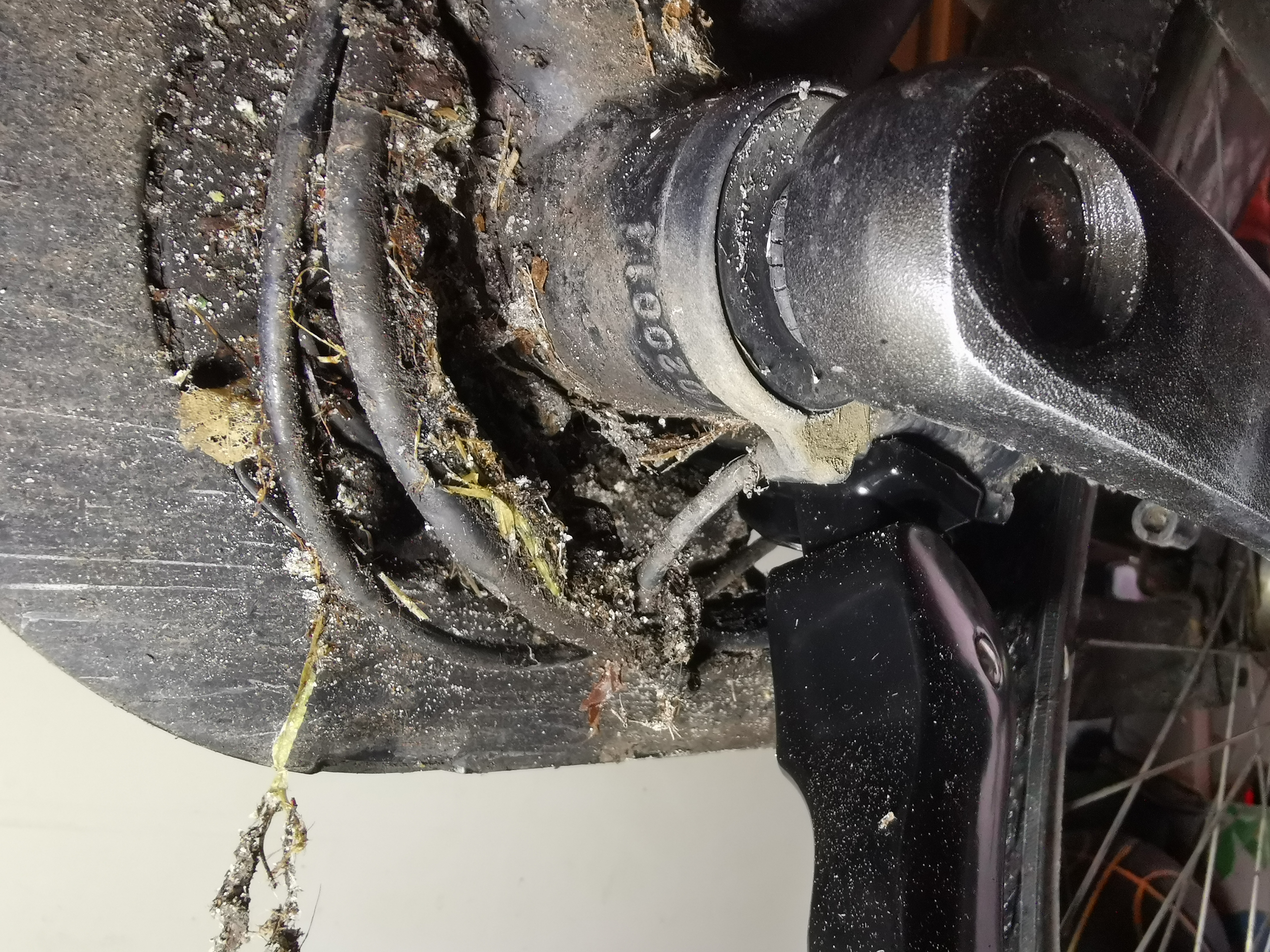

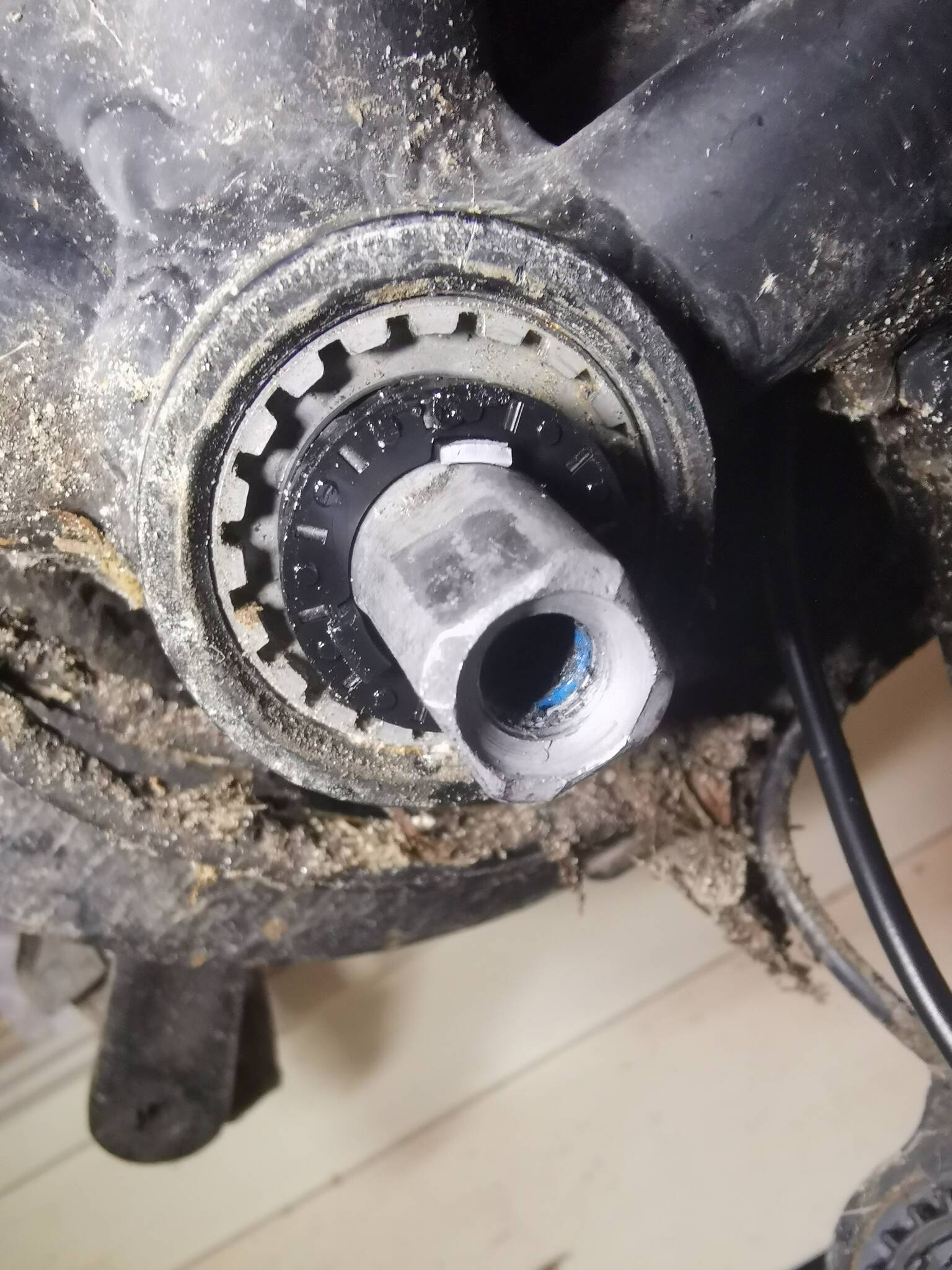

I'll order the kit you reccomemended - the bottom bracket on my bike has the PAS sensor built in, it's got a similar plug to the motor - I will count the pins - can I use that or would I be better off getting a different PAS from the same place as the battery and a throttle of some kind?
