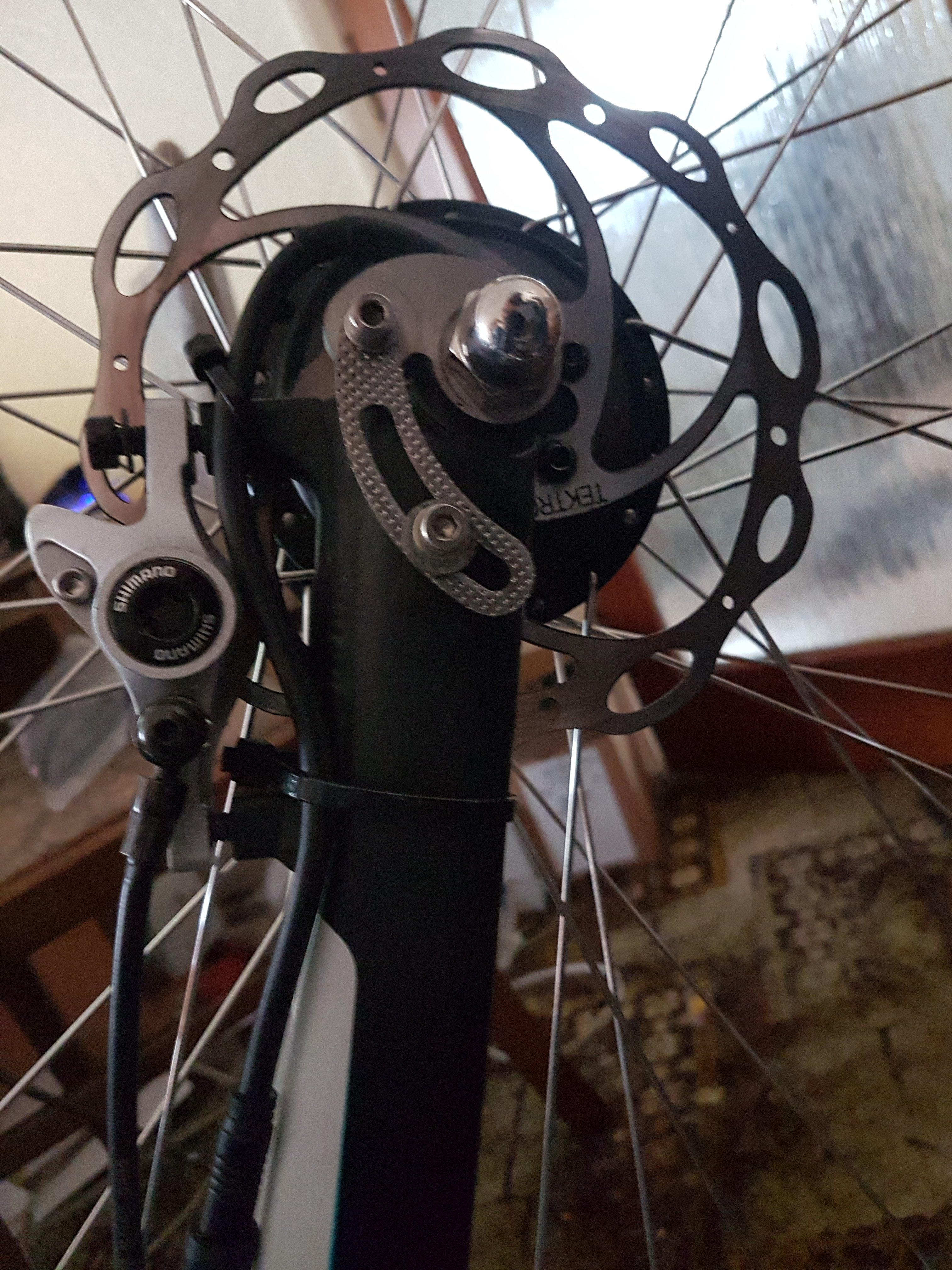

I just pulled the connector apart on the motor cable and was surprised to find that there was 8 pins, 3 thick ones, presumably the 3 motor phase connections then a further 5 thinner pins. Is this a standard motor configuration or specific to Gtech Ebikes?
No quite standard nowadays you have hall sensored/sinewave hub without internal speed sensor, a lot of modern hubs also use a ninth wire for speed sensing.
I did mention it in #4.
If the GTECH doesn't use a display then it has no need for a hub with a speed hall, if you change controller and want an lcd which will have odo reading you simply use a speed sensor with magnet to the rear wheel and wire it to the controller pcb or controller wiring dependant on the type of wiring the controller has. Some use water proof sealed connectors and some use JST Sm connectors.

So I would just use the 3 phase connector pins and ignore the rest then. The Gtech eBike doesn’t have an lcd display, the only other wire is the sensor in the pedal hub, that plus the 8 pin connector from the motor both connect to the motor controller unit. So I assume I’d use an external motor controller and hopefully utilise the existing pedal sensor? Can you suggest a suitable controller and lcd display, it looks like a minefield! Cheers
