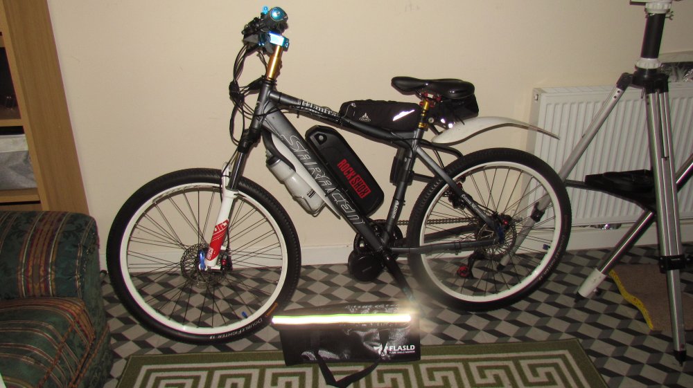

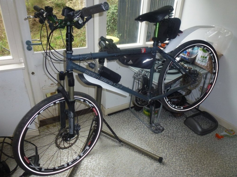

My (now quite old) GSM mid drive (from woosh) needs a new chain ring. Does anyone know if the bbs01 chain ring would fit? The issue that has developed is the chain keeps jumping off. So I was going to replace the chain and ring ( and possibly the cassette).

So no spares available, does anyone know if the bafand chain ring fits a GSMoon. I guess there won't be many around anymore!

Andy told me that we don't have them in 46T but we have them in 42T (or 44T? he said that he will reply to you).
You can use BBS01 rings too.

Thanks, I picked up a bafang 44t to check. It does fit, turns out the issue was a cracked chain. Back in service, although I suspect after 7 years of service it might not last too much longer! It’s been a great motor! Thanks again for the help.
