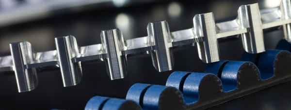

I see kalkhoff have a gates belt drive with their 2015 s class endeavor.Not having much knowledge of this type of drive, does anyone see this as a good idea with a powerful 350watt motor or is their potential problems
The power won't cause any problems, some of Harley Davidson's huge engined motorcycles use these toothed belt drives and car camshafts are commonly driven through them.
So it's a very sensible maintenance free choice, only the possibility of not having a spare locally eventually being an inconvenience.

There are two differences, the belt is slightly less efficient, regardless of what their manufacturers claim, and it's tensions are normally higher to ensure no slippage.

My contribution is always belt life - Gates give it as 'about twice that of a chain'.
Doesn't seem much given the expense of the belt and the cheapness of a chain.
Against that, I suppose, is the fact that most users don't use their bikes very much, so if you are changing a chain only every two or three years, a belt should last five or more.
I would say so too Rob, given my experience or working with toothed belt drives for years on static machinery and their use in cars.
But life is not the only advantage, the much greater one for most is the freedom from the tyranny of lubrication and cleaning that bedevils chains.

But as your comments about efficiency and importance of tension demonstrate, the belt isn't quite the gold-plated win-win solution it first appears.
The only belt drive bike I've tried popped the belt off one of the rings after about half a mile.
That was the end of that, because you can't just wind it back on again.
Agreed, it isn't. The alignment of belts is hyper critical, if it's not perfect they will either run off, or if side-guarded against that will chew themselves to ribbons.
But if set up properly they do have the mentioned advantages that many value highly. Given my experience of them, I'd be happy to have one on a utility e-bike. Conversely I certainly wouldn't want one on an unassisted sport bike, but since that would usually use a derailleur, it wouldn't be in question.
We have sold several of the BlueLABEL Charger beltdrive bikes I was impressed but this is in part due to the general quality of the bike. Although I agree it would be nice for them to last longer. The biggest advantage is that you do not need to lubricate it so ideal for someone who wants a low maintenance bike.

I drive my kalkhoff endeavour with Gates belt since a week. I bought it for my daily travel from home to work (27km each way). I chose the belt drive because it's maintenance-free. After a few hundred km's I can say it's a great thing, in combination with the Shimano alfine.

They all come with the CDX sprockets and belts with a centre track guide
It's a bicycle, so solving one problem can cause another.
The centre track belts all but prevent roll off, which is good.
But the downside is the wider belt makes a platform for grit to take up residence.
Grit on the inside of the belt, when mashed by the cogs, can wreck the belt.
