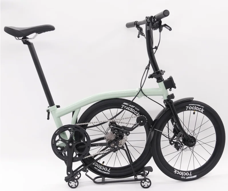

Hi all,
I'm looking for a front hub kit for a 20 inch Brompton clone (Mint T9-20D). I don't have the bike yet as it's still shipping but wanted to get some ideas about possible kits.
20 inch wheels with mechanical disc brakes.
Front hub kit ideally 250w road legal but don't mind a bit more, 36v. Looking for a fairly light battery I can clip on a bag at the front. Ideal would be something that still allows the bike to be folded up pretty quickly and easily detach the battery when required. Smallish display and throttle if possible. Something with a bit of grunt for hills but not expecting too much.
Would prefer something already built into a wheel but will also consider motors without a wheel.
Does anyone have any good suggestions?

Thanks all for the recommendations. The clone I've ordered has 20 inch wheels, I think Brompton's (apart from G-line) are 16 inch wheels. So I'm looking for something similar to the set up for the Woosh bike but 20 inch wheel instead. Also been looking at aliexpress, pswpower, etc but not sure if they would fit.

That's not a good bike for conversion if you want an off-the-shelf kit. The forks are too narrow at both ends. A mid motor would fit, but then you'd need to sort out the gearing, which would be too low with standard parts.
Some of the Chinese resellers , like BMSbattery and Topbikekit offer the narrow AKM motor either on its own or built into a wheel. It's OK in a 16" wheel, but a bit gutless in a 20" one due to the lower torque. If you don't weigh much, it'll be OK, but if you're say 90+ kg, it might be better to get a 260 rpm one and run it at 48v to increase the torque a bit.
It's a lot easier to decide on a conversion first, then choose a suitable donor than it is to buy a random bike then try to figure out how to convert it.
In summary, it can be done, but a lot more messing about than buying a Woosh kit.
