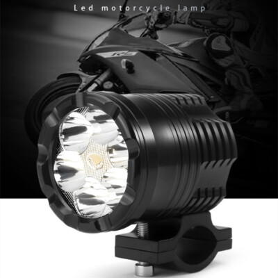

If you mean these, I agree with you:
I bought one for the fork, but the beam was too narrow to be useful, so I bought two more and handlebar mounts, but again I couldn't see the damn road at night.... just three small bright-ish spots! The only one I've kept on the bike, points backwards from the handlebar at my hi-visbility blouson, because hi-viz is only hi-viz when reflecting light. I must look pretty weird at night - weird is prefereable to squashed!

I use two of these "1800LM" plus a "2400LM" on my handlebar, and another 1800LM made red for the back, on flashing mode. And another big (in terms of dimension) "70LUX" light on the fork. Together, they do a great job of clearly lighting the road surface ahead of my bike at night, and just one "1800LM" light was good for being seen at night. More than one is better for being seen during the day, especially if at least one of them is flashing. As far as I can tell, it seems UK stock is depleted, they're now advertised as "3200LM", and shipped from China:

Fwiw ive opted to add this front lamp
the key feature being the 'universal input voltage' chenglish for what i understand to be a wide range of input voltages.. tho i will be running off 12v via a dc/dc converter.
not in the same league as @guerney 's solution but not needed to perform the same pothole illuminating duty as i ride in an urban generally well lit area, its making myself visible thats my primary agenda with multiple lights..
