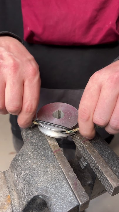

Fitting a tyre the easy way?

I'll try that next time. I suppose it depends on how tight a fit the tyre is, that tyre looks a loose fit. Doubt it'd make fitting a Marathon Plus easier - I put reusable zipties either side of the bulge to keep it in place, and push the last bit over with my hands, which doesn't take a massive effort.
8,262
3,774
It'll work as an alternative to tyre levers, but for many tyres, you need to work the opposite bead into the rim's well so that the final part of the tyre will lift over the rim. That's the same whether you use levers or rope; however, if you use the proper technique, you don't need anything except your hands.
Reactions: robert44 and flecc
