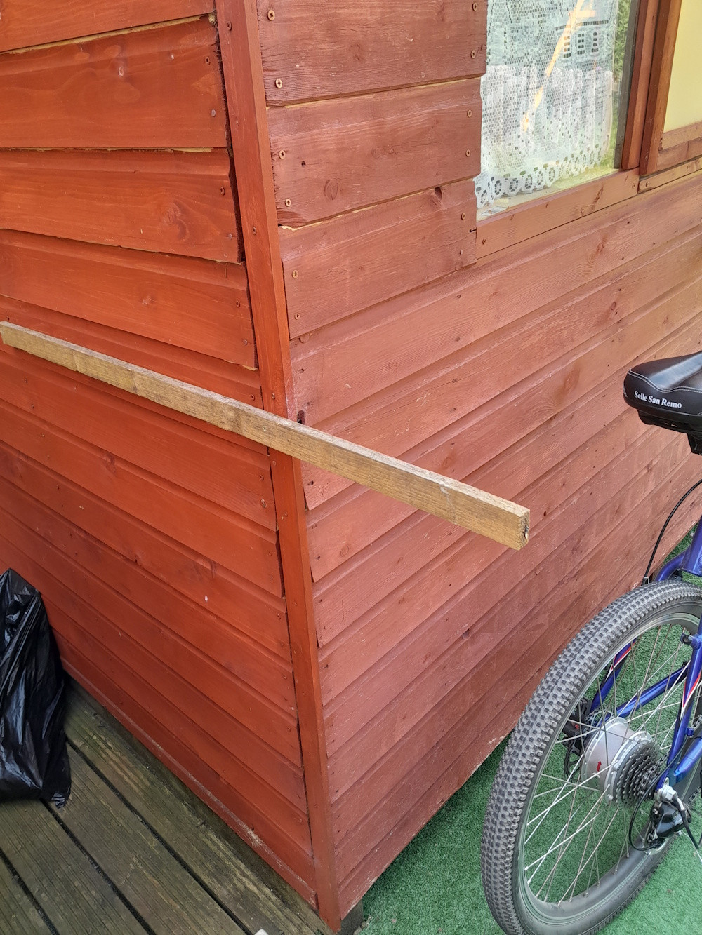

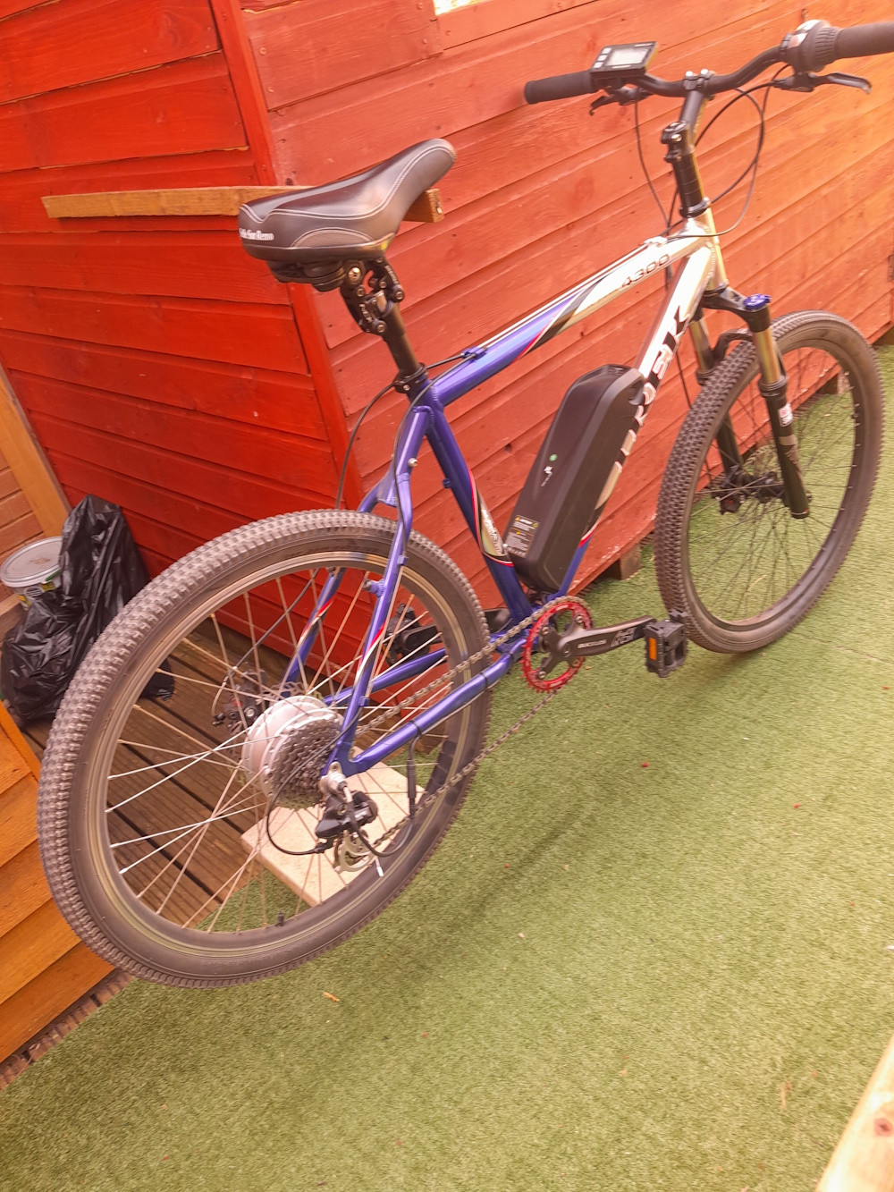

My budget method of lifting the rear wheel for gear adjustments etc.
Great idea.
