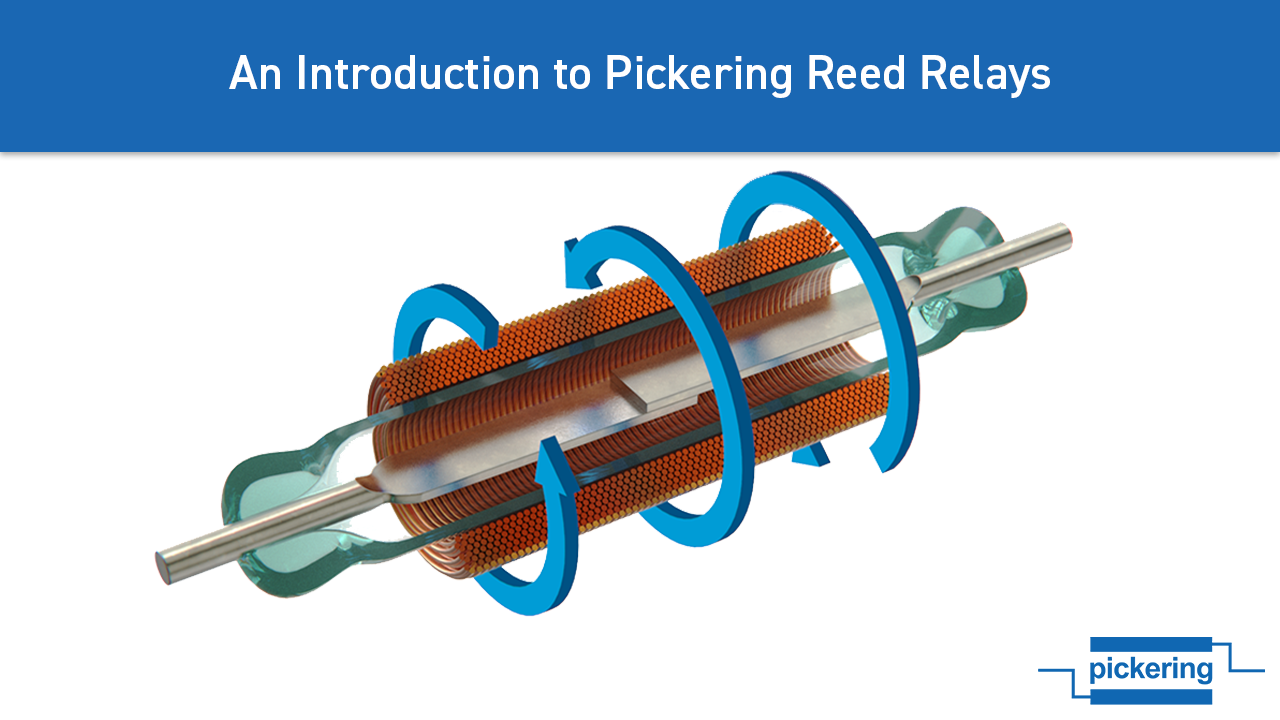

My horn and my USB hub is 12v running on a 12v 10a converter and my front headlight, back light and turn signals are running 72v
Then if you want to use the turn signal 72 volts, to operate a relay to switch the 12 volts for the new turn signals, that's an easy fix.
It may even be ok to make your own by wrapping wire around these:-
With 72 volts as the signal, you probably will only need a dozen turns or so.
Experiment.
They are also very cheap to purchase.
You may find this instructive:-
regards
Andy
