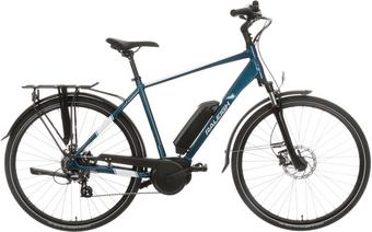

Hi. Since Brexit, unfortunately, Irish people buying from the UK has extra taxes and complications. Anyhow, one possible recommendation from Halfords 'Black Friday' sale (Liffey Valley or elsewhere) is below.
or for larger size frame choice, bigger battery but fit your own mudguards below.
