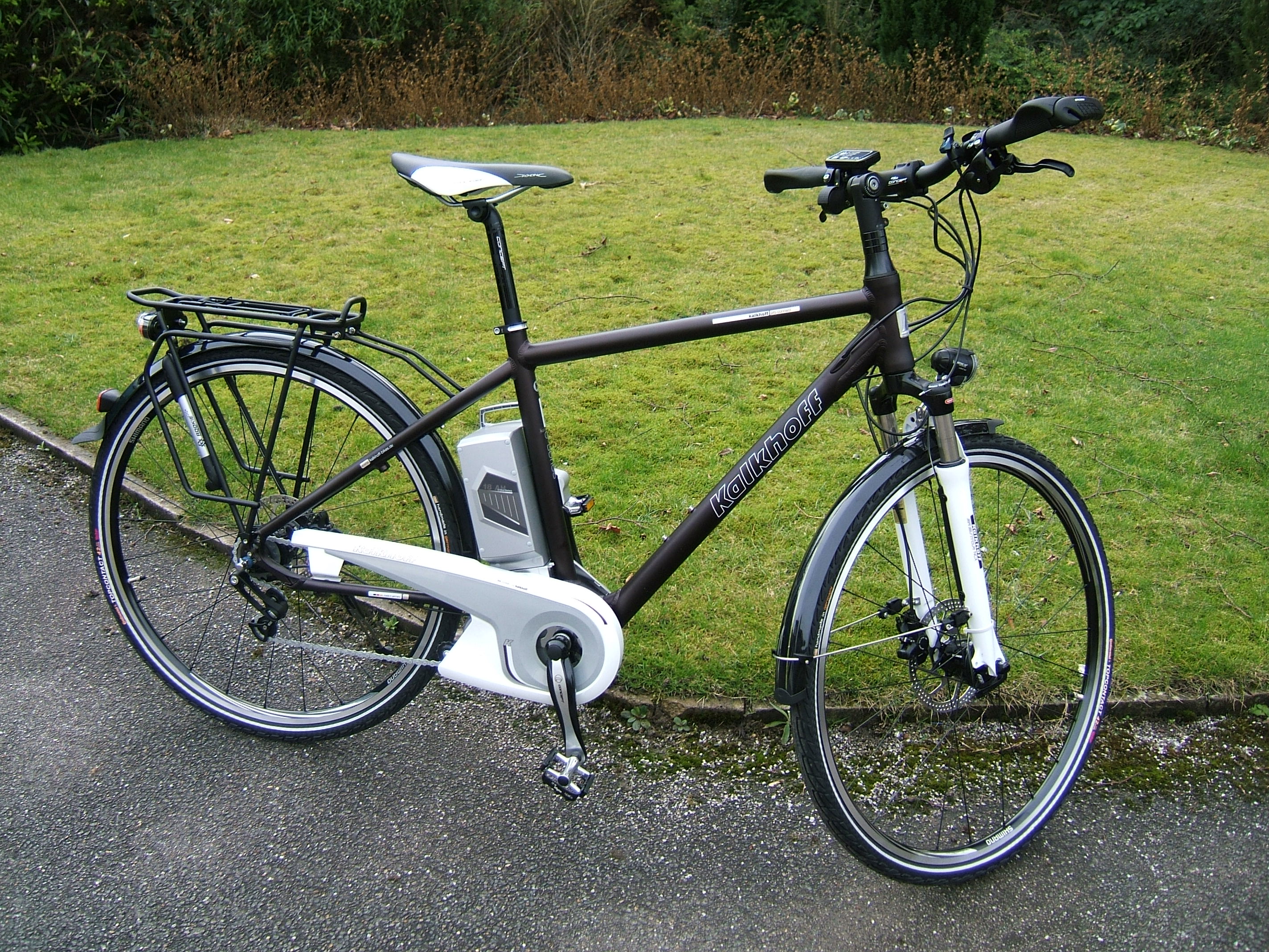

apologies for slightly off topic, but that piqued my interest so i went to look at the halfords website, to buy that for £1100 i'd have to really ask myself why i'm not spending a few hundred more for a crank drive kalkhoff
That's a really good question, but what's the answer? You could also ask the question different ways. Why not spend a few hundred less for a hub drive Woosh, or why not spend a few thousand more and get a top of the range Haibike. These questions are not easy to answer.
