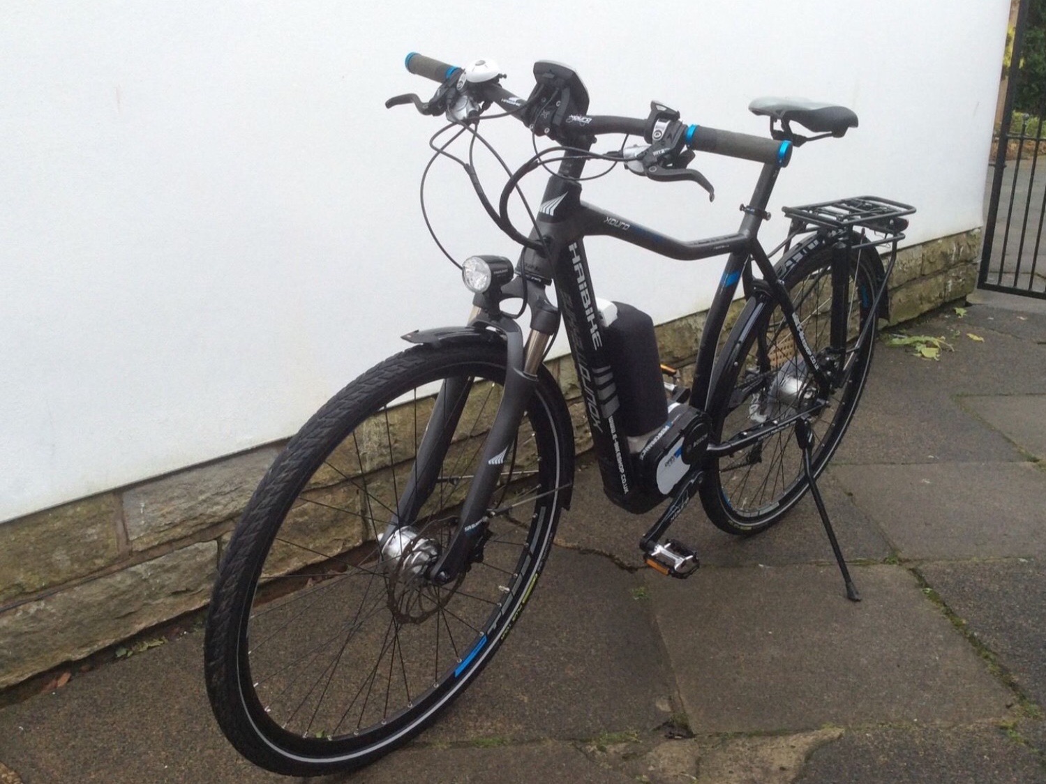

So...... about 6 months ago something started jumping out of gear when the bike was in top (11T) - this is on my haibike - the problem seemed to go away if I cleaned the chain thoroughly and lubed it up well.
Well now it jumps out of gear quite a bit - but only in top - I can't tell for sure if its the chain coming off or what it is - but in top if you put pressure on it something is jumping out of the gear.
Have attached pictures - what do you think - does that top gear (11T) look worn to you? I have done around 3500 miles on it - must admit I have a dongle on the bike meaning we are doing quite a bit of 25mph+ riding - and if you think it does need changing ought I to change the chain at the same time?
Any thoughts welcome.
Cheers.
James.
PS. My paranoid fear is that its nothing to do with the cassette and something inside the crank engine is broken (though why it would only do it in top gear is beyond me).

There's nothing wrong with your motor. Your top gear doesn't look worn enough to jump, so that leaves gear adjustment or worn chain.If you can get it on a bike stand, wind the pedals in top gear to see if the derailleur is holding the chain in the middle of the sprocket. you can apply the brake while your doing it to see what happens when there's a bit of load.

Put your bike in first gear and try to pull the chain away from the gear teeth. If you can see more than 1/8" of space under the chain, it could be worn out. Sorry to disagree Dave, but the 11t looks scalloped out and a new cassette may be in order.

As in the picture I thought my 11t sprocket looked worn out too.
On further investigation I discovered the teeth on a new sprocket were not symmetrical either.
Apparently there made that way for smoother gear changes.
( I never noticed your mileage and high speed usage in your original post. On second thoughts the cassette is probably due for replacement although its hard to tell unless you see it with a new one, side by side)

It does look worn to me but as Kenny says it may just be the way they are designed.
At that mileage, if you do decide to replace the cassette I would consider changing the chain at the same time as they may not mate up with each other and still give a problem.
You will need new ones at some stage and if the problem isn't cured by fitting them you can put them back in the box till they are needed and go on to further diagnosis.

11t cogs always jump!
I have tried 3 now, both Shimano and Sram. They are simply too small to take the pressure.
Like Mike says, 11 teeth is small. The actual numer of teeth engaged by the chain can be adjusted slightly. The single screw that rests against the dropout can be turned out to let the mech engage more of the gear with the chain. This however can affect the smoothness of your shifting.

I decided to run my Haibike until the chain jumped. Started jumping in top gear. Left if a bit too long and the 11 tooth sprocket snapped in half one day.
Replacement cassette and chain soon sorted it. I think 2500 miles was the mileage for the cassette at the time.

It is often hard to see when a sprocket is worn, especially if like me, you have eyesight issues. If you think that a particular sprocket in a cluster is worn, compare the width of the flats on the tip of the teeth with those of an adjacent sprocket. It is often easier to see wear by this method. a worn sprocket has narrower flats.

Thanks everybody. I think I need a new cassette and chain....... I've played around with the derailier - doesn't make much difference - the chain pulls off the lowest gear a bit but hard to tell (thanks for that tip)...... those teeth not only look uneven to me (designed like that so I am told) they also look very small/worn in places compared to the cog above.

The cog looks worn to me, but as has been said, the different shaped teeth on Shimano cogs can make judging wear difficult.
I also agree it's a very small cog for the application.
With that in mind, could you put a larger ring on the front?
That might enable you to get the speed without using the smallest cog as often.
Martin has a range of sizes.

When mine jumped I held it on by holding the gear changer down, that stopped it. But it was new then yours is wearing but might help. If the other gears are OK does it matter?

From memory Rob he already has a larger sprocket, good shout though.
A simple chain & cassette to resolve. Looking at about £65. Not bad over 2500 miles thats 65/2500= 0.02 a mile and a few charges :)
