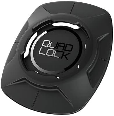

If superglue + baking soda (or the stronger superglue + graphite combo) doesn't dissolve the display's casing or Quadlock case plastic, one could be cut to fit the back of the ebike display and permanently bonded on, for easy twist and lock on/off?
...but at that price, particularly desperate thieves may steal the Quadlock mount! Might be wise to superglue + baking soda the bolt... which can be dissolved if needed (albeit slowly), using acetone (which also strips paint).
Reactions: Bikes4two

GoPro comes to the rescue once again lol... this seems like a cheap but secure option to secure displays to handlebars, with quick and easy removal: Cut off the short 1/4" bolt and file that top surface flat, then adhere it permanently to the back of the display using superglue + baking soda (or graphite). If it's a large display, perhaps add a supporting plastic layer in between. If superglue doesn't melt anything.
If the button pad is separate: It's unlikely to be of interest to thieves, so perhaps cutting the cable which connects it to the display, then soldering on some kind of appropriate waterproof connector would suffice.
I've got a cheap plastic version of this already, and there's a wide variety of cheap GoPro-type (cheaper than Quadlock!) quick release alloy and plastic clamps, arms and mounts:
The rails could be filed off this one, and the display (or button pad) bonded on. The bracket is slotted on one side - undo just one bolt for quick release. I can't find this to buy anywhere in the UK:
Pricier official GoPro quick release clasp with release button - the display or button pad could be bonded to the mounting plate, after the rails have been sawn off and filed flat... or quick release by undoing one bolt:
