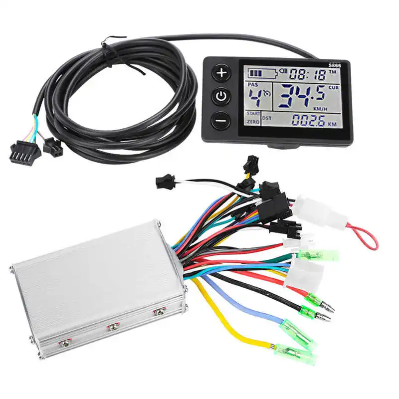

Wow that is the most minimal ebike display/controller I've ever seen. If the hub motor has a standard connection bafang type I guess you could get a new controller and display and a cheap third party battery. You'd need some basic electrical skills.
Controller + display (probably best to buy them together)
battery 36V maybe £60 from aliexpress with decent cells, £30 with crap cells of around 200Wh capacity.
charger if you can't use your old one.
I personally wouldn't consider buying a expensive genuine replacement battery. I think its beyond the worth of the bike.
I'd probably buy a controller and display about £25-30, charger £5-8 and battery £40-80. All from aliexpress. Most people will warn you off aliexpress batteries but if you are careful who you buy from, from companies who have sold a lot of batteries and have a lot of good reviews and a high average score I feel its safe myself but others will warn you against them.
However this route will require a lot of cable cutting and soldering.
This is the battery I would probably go for, about £60 after delivery and tax and is 245Wh (6800mAh)
and this controller with display which is less than £30 delivered.
Once converted you have a non-proprietary ebike, free to repair and upgrade as you wish.
