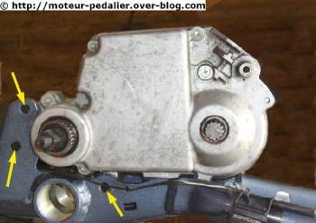

Many of us who have owned Panasonic crank-drives have had to deal with just such a problem but your Agattu does not utilise the Panasonic motor in its later incarnations, I believe. Should that be so, it may still be the case that the noise issue can be cured by slackening the motor mounting bolts, shuffling the assembly around a little then re-tightening the bolts. In essence, that was how I cured my problem.
Unless you are familiar with sockets and spanners, I would caution that some care is required when tightening these bolts so checking out the torque settings and actually employing a torque wrench may be best practice.

Arrowed is where the three mounting bolts are on the new type Panasonic unit, frame upside down in this photo of course. Your Impulse motor will have similar mounting bolts, possibly three or four which might need to be tightened. Units bed down quickly due to the paint thickness in the frame mountings crushing under the twisting pressure of pedalling.
But do make sure it's not a crank bolt first, it often is.

OK - have tightened both the left & right crank arm retaining nuts to no avail so must now move on to the motor mounting bolts. From previous posts I'm assuming these are HT socket head cap screws and whilst I have Allen keys and a socket set with me in the car I don't have any Allen sockets, as I'm on holiday at present. Will tackle this when we get back home next week. thanks again for your help & watch this space.
