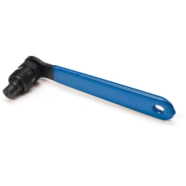

I have never used the company in the lists but it gives you an idea.

Some of the crank extractors (2nd picture in message) have less threads on them. I found the Park one to be better as it has more threads, both of the Park tools are good.
