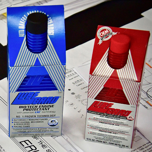

"Thanks to the critical role that sperm whale oil played in making automatic transmission fluids and gear oils, car transmissions routinely lasted for the life of vehicle. Once alternative ingredients had to be found, transmissions began failing at unheard-of rates. Before 1972, less than 1 million transmissions failed each year; without sperm whale oil, transmission failures exploded to more than 8 million by 1975."
