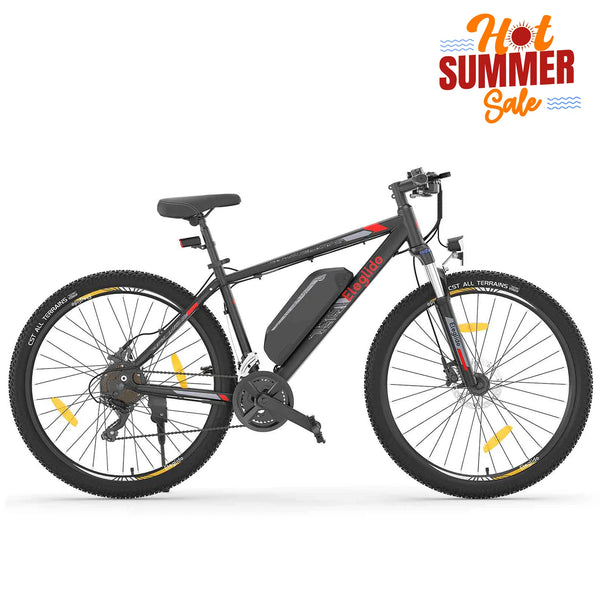

A cheapo option would be the Eleglide M2
