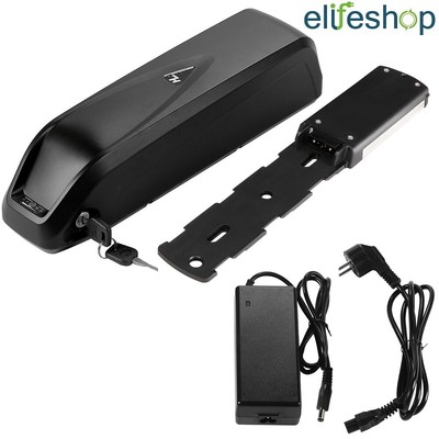

Has anyone here had any experience with a kit like this? Seen it on an andy kirby vid, there's a similar kit with the downtube battery at 36v/10ah for about 15 quid more, here
Id hope to spend around this amount as a first step into e-biking, replacing the kit with something better when I'm more confident. Not sure what the range would be on a 7ah battery mind...

if you buy from China, you need to factor in freight, import duty, VAT and support cost.
the most expensive component in a kit is the battery. It alone accounts for half the total cost. Batteries come with inherent fire risks, that why it's always prudent to choose a top brand: Panasonic, Sony, Samsung. You pay for quality manufacturing and control.
The second most expensive component is the motor. It accounts for about 30% of the total cost. Again, pay a little more for a top brand because you need to be sure that there is quality control. Choose a good brand, Bafang, Mxus, Shengyi, they are the biggest producers and best organised. Some companies offer me their motors for $30 and a quick look on youtube, I find their motors in large piles on the floor during manufacturing.
Other components also deserve careful selection: LCD, controller, design, specifications. Again, big brands offer better quality control.
