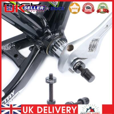

you need a long M8 bolt to hold the tool like this:
I bought one of those sold on ebay for £2-£3 but forgot what they are called.

found it, it's called an anti-drop tool:
The price has gone up so much! it's now doubled what I paid for it.
Nice! Haven't seen those before - I rattled through ebay looking for it too, this seller has a better rating
