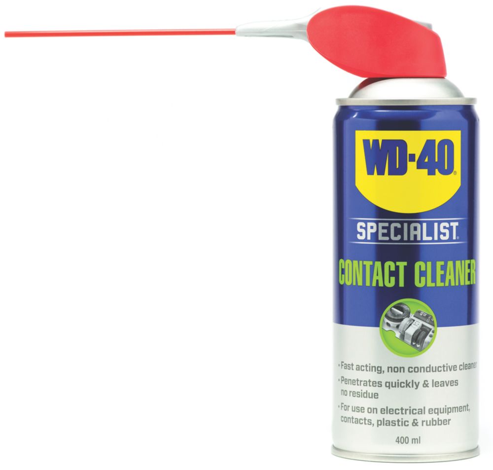

you could try and spray some of this in the buttons but will do a better job if you can get at the pcb inside.
