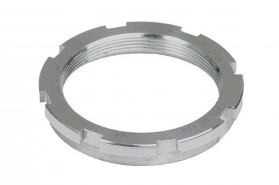

Thanks for that Eddie- the sprocket guard is a "Miranda" one that came with the bike- what is used instead just a lockring? Where from?
My only concern in doing that is a loose lace or bit of clothing getting snagged up in the chain/sprocket? But after each trip I always have to remove crap from behind it, usually heather....!
Use the ring that SW has provided in the link for. It is a very simple swap.
I understand your concern ref the clothing, and obviously I would be a fool to say that it might never happen, but all that I can say is that in the many years that I have ridden without one, I have yet to have had an issue.
I also know what you mean about heather. I find that heather, bracken and gorse cause me more issue than anything else. The issue is with the rear mech and jockey wheels in my case. I never really found it a problem when running a Shimano set up with Sunrace cassette, but with EX1 it is a constant battle to keep the stuff from wrapping around. It is the holes in both the cassette and jockey wheel that cause me an issue.

My days of clipless are over unless I'm on the road! Especially now on sharp climbs where if it goes awry you can never get out in time...I remember after doing techy bits on my Shimano MO86 spd's and on 520 pedals with my arches on the pedals and thinking "Naaa...had enough of this lark". I ordered a lock ring for 7 euro from bike24 as I needed to get stuff for servicing the Pike forks sometime soon...
