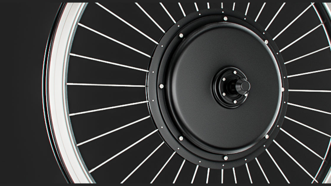

Hi everyone,
I am new to pedelecs and I saw that you help a lot in information sourcing.
I am building an urban ebike and I am trying to pick a decent quality ebike battery.
I was going to purchase from Unit Pack Power but a friend of mine told me about couple of cases which their batteries caught fire. Also I am looking for a branded battery with A Graded cells like LG or Samsung.
The rear hub is 1500W and I need decent Continious Discharge 30-40A.
I have read comments about Greenlance E-Bike battery and Battery Empire but would appreciate any information about them and genuine reviews if anyone bought from them.
