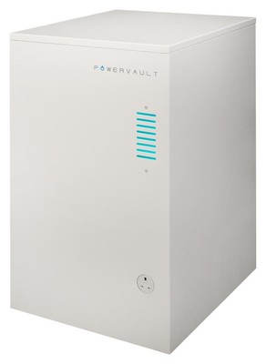

Expensive, for sure. Here is a 3kw one for example
Not exactly convinced your average cafe will
1. want you to wheel in what amounts to a home power wall and then
3. be happy to charge it for you for price of a cuppa or two
2,469
