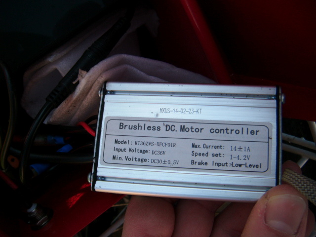

Hi all I have been using this for a couple of months now and it works perfectly for what need. but due to the weight of the total rig and although I pedal it and only use the Medium Power setting I am only getting 3 miles range.- I don't use the throttle only pedal assist
I know that this is good for the weight it is pulling but I would like go large on the batteries and I would like to know if I can wire in some wheel chair batteries to get a greater range? and would my existing charger work
It is 36 v and I have 3 small batteries.
What are my options

Typically electric bikes use lithium batteries, and a 36v nominal one is actually quite a bit above when charged (42v), dropping as charge is taken. The controller typically will cut out to protect the battery if the voltage gets too low. Yours starts at 36v, and drops to maybe 30v (from the spec sheet) for rated capacity. The controller may just be cutting out long before your battery is used up. You could get an idea of that by how long it takes to charge again. Also, I am not sure those batteries expect to deliver continuous amperage needed for an ebike.

You can go at large as you want on batteries, space and the extra weight are your limiting factors. Lead acid batteries are not a good choice for electric bikes, esp. as you are running a controller designed to be used with a lithium-ion pack. Expect to use about 50% of their capacity before the voltage drops too low, and the controller cuts power. If you have a 36v Pb charger, then it will charge any pack of 3 x 12v batteries. Obviously, the larger the batteries the longer they will take to charge.

thanks you might be correct as it recharges to full very quickly - less than 2 hours I suspect - but I will monitor it this afternoon to be sure, also I will check the voltage when it thinks it is flat. What I do notice is that the battery @monitor (which is 4 red less for full) goes from 3 lights to flat in about 500 meters.

What you see is voltage collapsing/sag, the batteries can not deliver the amp load asked of it.

thanks so today I did a 4.3mile ride on it (towing) no use of the throttle, on LOW mode and even after 2 miles I was still on 4 leds, then 200 yards from home I went from 3 LEDs to 1 blinking LED and I popped the multimeter on and it says 44.7 Volts and 2 cells we 14.xx and one was 15.x.
So I am now thinking that my batteries are fine but my controller is cutting out way too soon?

That will be voltage sag, and yes, it's the controller cutting the power. Might be worth checking your battery voltages with another meter, 14.xx is too high for a SLA battery, unless you have an alternator fitted to the bike.

You need to rig up the volt meter for a reading whilst riding to see the actual voltage collapse as you go along . SLA's aren't usually able to deal with constant load and will sag badly inducing voltage collapse.
There is nothing wrong with your controller. It's electronic so it can't change any of its settings without someone opening it up, unsoldering components and soldering in new ones.
Your lead batteries are simply past their sell by date, which is the almost certainty that anyone will find when coming across one of these bikes. Replacement lead batteries wil cost between £70 and £100 for the three. You must make sure that replacements are for electric vehicles, like invalid buggies, golf carts or electric bikes. A lithium one costs twice as much, but will take you twice as far and weigh half as much.

Hi all great news for me, I went to great shop in Swindon, and they provided me a new controller to take home and test, and it worked the same as my old one.
So I have ditched the lead batteries now and fitted a new 400Watts battery designed for the rear of a normal bike in a rack, and I have modified the rack to fit in the basket.
Its waaaay lighter than what I have removed, and has a light on the back also!
So I hope it will last for at least 10 miles (towing) and i will test it out tomorrow and I will update here with pictures
