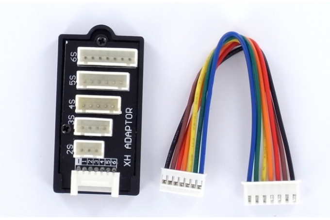

Mine comes with a small board a bit like this one:
you can then charge the cells through the balance wires or get a bunch of crocodile clips

That's great solution if I leave the packs wired. The crocodile clips would allow me a better flexibility.
