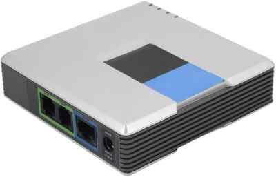

I have existing dect phones that I was hoping to use via an adaptor, using voipfone as they say they can port my existing number for £5/month.

I used to connect the DECT phone via a Linksys adapter. Fiddly to set up VOIP, because it's all done very slowly via voice prompts and all settings entered through the phone keypad - had to use a wired phone because the DECT tones weren't compatible. Worked great till Virginmedia blocked it, which they deny because they're not supposed to block competition. These used to cost less than a tenner. Not made anymore, not the genuine Linksys ones anyway.
Now I use cheap old mobiles for VOIP instead, through the free Zoiper app.
