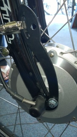

The BS01 is easiest to fit, only requiring standard bottom bracket shell, 64-68mm in length. Hub motor kits need a bit more attention to the donnor bike. If you fit a front hub motor, you'll need to make sure that the fork has standard 100mm dropout and is strong enough, especially if you want 500W motor, not only you need to fit torque arms but also it's man enough to take the power and weight. Similar considerations if you want to fit rear hub motor. Most kits require 135mm rear dropout, 500W motors will require fitting torque arms. If you have disc brakes, you need to buy the hub motor with disc brake bolt holes. Most conversions go with seat post mount 'frog' battery or downtube mount bottle battery. The new square bottle battery is better than frog battery or round bottle because you can buy larger capacity 48V 10AH or 36V 15AH.

If you want a high-torque motor, you'd be better with a rear one for safety. You need a bit of experience to install a high torque front motor unless you have steel forks.
