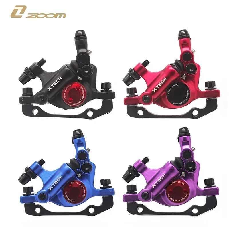

2. Brakes
Cable disc brakes are always a bit meh. These ones are noisy as well, and the back caliper was wrongly positioned so that the pads were only about 60% on the disc. I replaced them with these cable hydraulic brakes from Aliexpress, which are a lot better. Not as good as ones with hydraulic levers - about half-way between, though I have to say that they're not fully run in, and the back brake is still not fully on the disc. They're a direct replacement, though you need to solve the positioning at the same time, which means using a lower adapter or grind about 3mm off the existing one. I haven't done that yet.
https://vi.aliexpress.com/item/1005007182438816.html?spm=a2g0o.order_detail.order_detail_item.3.5e48f19cGnp5ex&gatewayAdapt=glo2vnm

2. Brakes
.... I replaced them with these cable hydraulic brakes from Aliexpress, which are a lot better. Not as good as ones with hydraulic levers - about half-way between, though I have to say that they're not fully run in, and the back brake is still not fully on the disc.
So I have replaced cable disc brakes with hydraulic (£30 for front and back mt200s on AliExpress) on a number of occasions (though never on a folder) and even with my fairly basic skills in bike mechanics, it was a 10 minute job everything just fitted. Is there some complication with fitting hydraulic brakes to that folder that made you choose cable hydraulic ?
I just wanted to see if those cable hydraulics were any good, because I never tried them before. They're a good solution for anybody that has enclosed cables or doesn't want to mess about with adding switches to regular hydraulics or pulling the grips off the handlebars to get the levers on. They're just quick and easy; however, when you know what you're doing, normal hydraulics with switches can be fitted just as quick, and they can be had from Aliexpress for only £10 more. I would rather fit them any time.

...They're a good solution for anybody that has enclosed cables or doesn't want to mess about with adding switches to regular hydraulics or pulling the grips off the handlebars to get the levers on. They're just quick and easy...
Agree 100% when I fitted them to my Fiido folder a year or so ago* now... brake cable routed through frame with an awkward fold mech, and of course brake switches made it too much of a faff.
