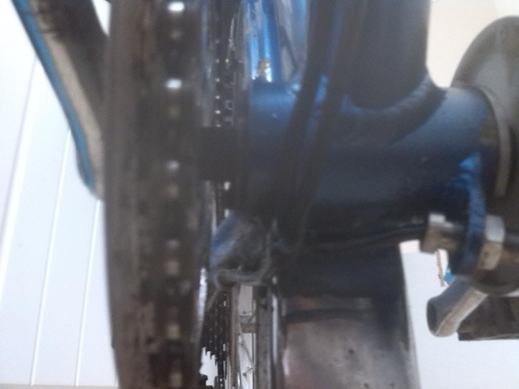

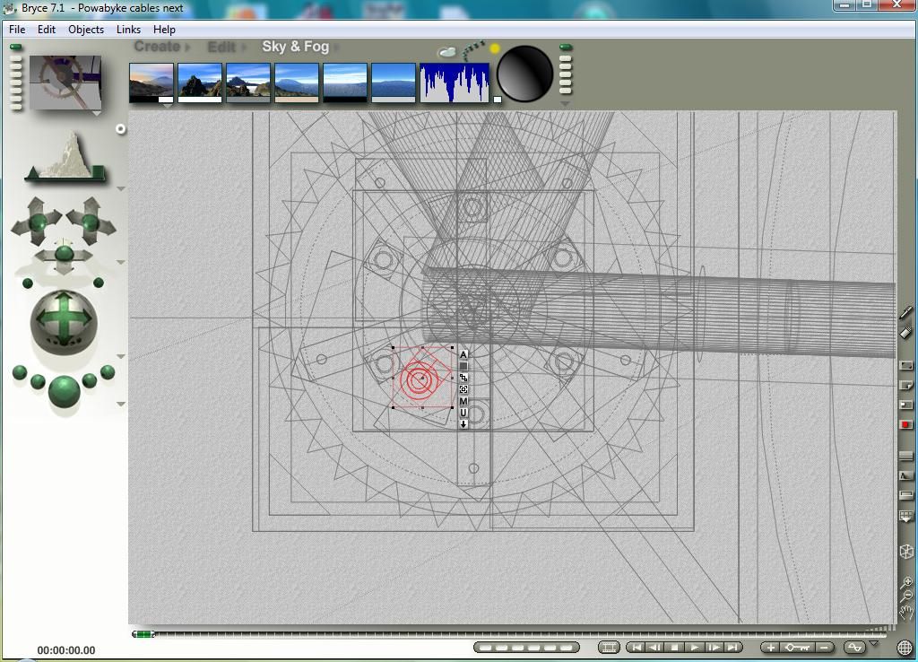

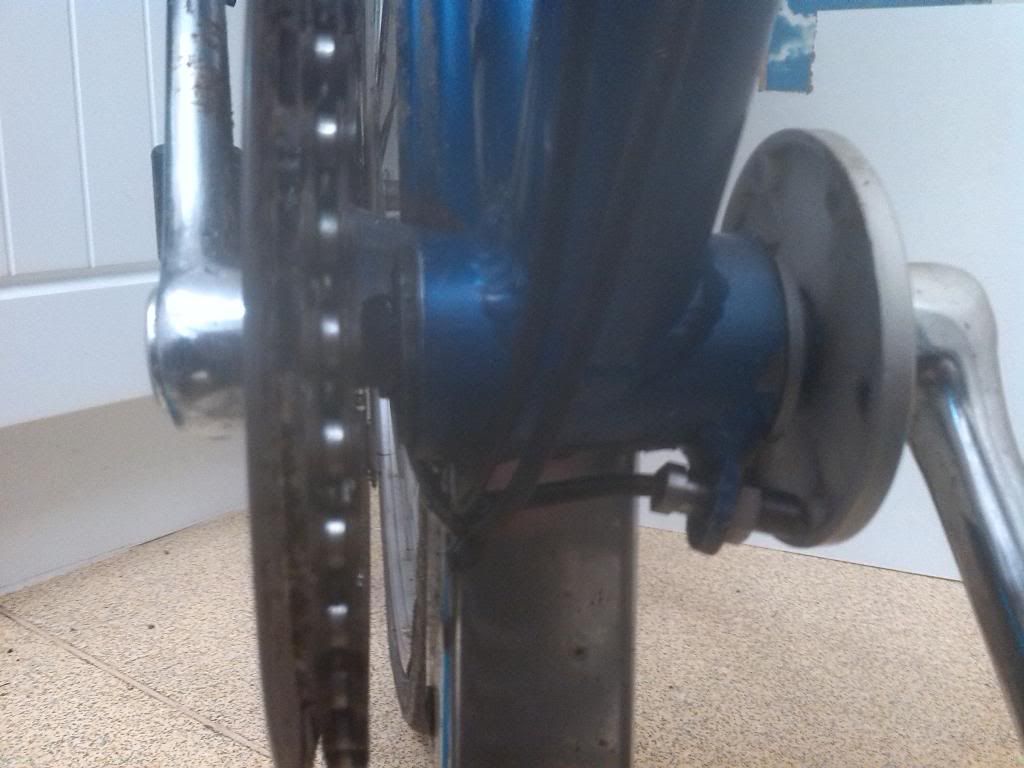

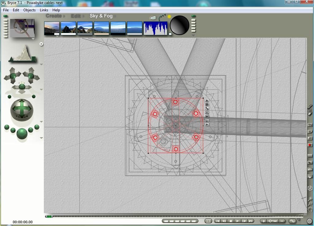

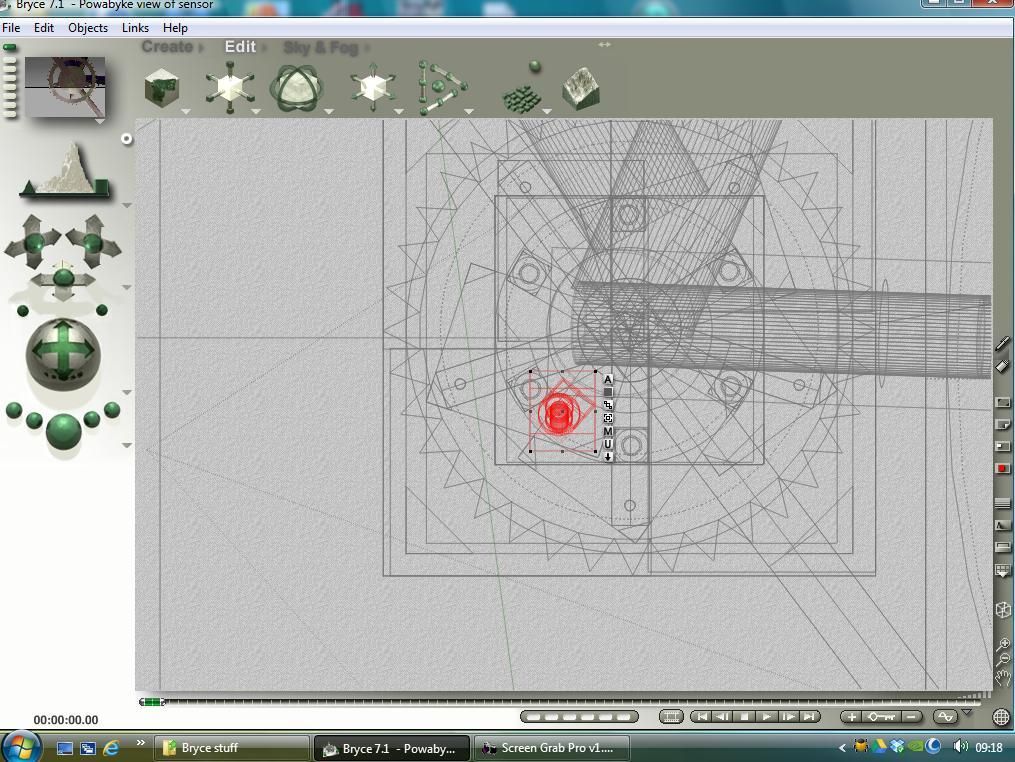

I've familiarised myself with the sensor arrangements but include my own diagrams and 3D images to show the sensor set up just in case some members are unfamiliar with the mechanism.
I enjoy playing with photo-realistic software and animations, such pursuits being a hobby of mine though note, while the whole thing is just about to scale, my Powabyke 3D model should be viewed more as art rather than being 100% technically accurate!
Here is the sensor, (below), highlighted in red.

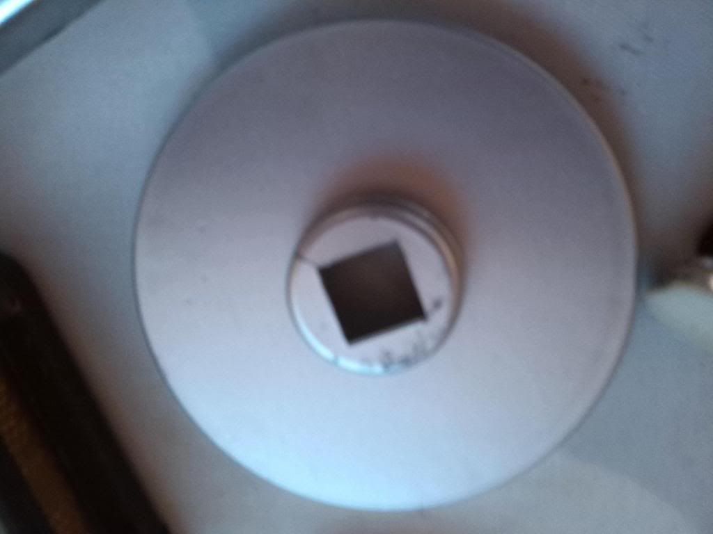

Here is the sensor disk, (below), also highlighted in red .The round components are magnets.
Here is a cool image of the chainset / sensor assembly, (below), showing the magnets on the disk.
... And here is a sexy, full frontal image of the sensor, (below), highlighted in yellow and juxtaposed with the sensor disk

If I apply that maxim, I can deduce that the actual sensor, (highlighted in yellow above in pic 4), must be working, sensing the revolving magnets in the sensor disk ... or, otherwise, Eva wouldn't know to start delivering power once she sensed that she was travelling at more than 3.3 kph.
